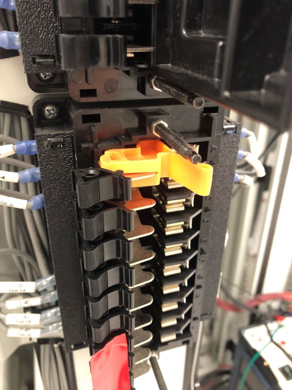

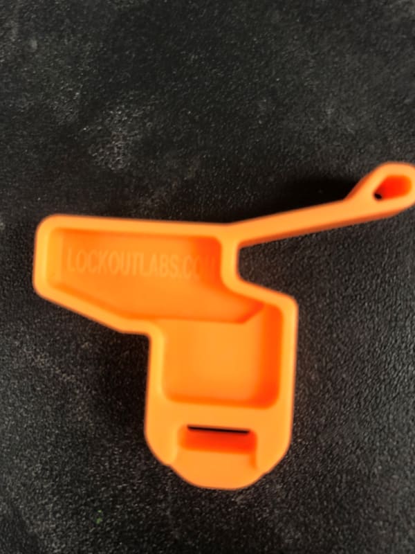

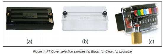

Hello,
I am wondering if anyone has come across a method to "Lock Out" a Current Transformer secondary circuit? I spoke with a colleague who had attended a conference many years ago. He mentioned seeing a locking mechanism that could be placed over the shorting bar in a breaker cabinet or shorting blocks in the control/relay house. Maybe a clamshell type shape. Has anyone come across this? I tried Googling around for an answer, but could not find one. Our company is improving our CT safety procedures. We are currently implementing a Tag Out approach, but would be interested in a Lock Out mechanism as well.
Thanks for your time.
