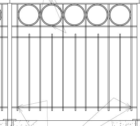

Does anyone have formulae to calculate shear, flexure and bending moment for a circular beam in plan supported on the four sides? The issue is as shown below. I know it's 'plenty strong' (the material is BAR 3/8x1-1/2 and it's part of a railing system), but I would like to be able to put some numbers on it... Thanks

The screen shot looks like an elevation not a plan to fwiw.

Where is the demand coming from? Looks like a decorative portion of a guardrail (in elevation)
XR... not sure... I just like interesting problems. I'm bored, so in my spare time, I like to write SMath programs for solutions. I have no concerns about sealing the design as it stands... I know it's 'good for strong' and I can connect everything with 1/2" of 3/16 fillet weld on each side. One of my many 'personal quirks', I just like numbers.

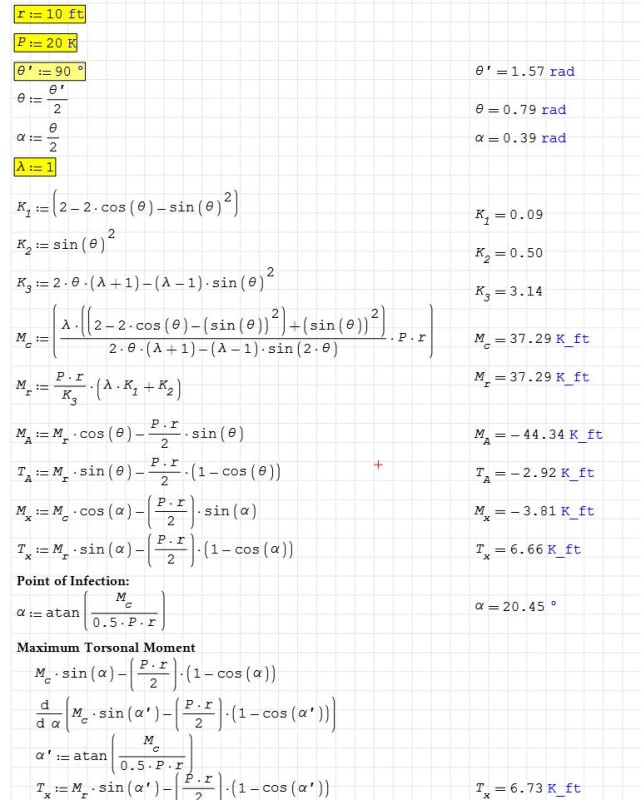

As others mentioned, Roark's and AISC DG 33 are good references. Another good reference is Structural Concrete Theory and Design by Hassoun and Al-Manaseer. Although it's a concrete textbook, the analysis part should still apply. Here's what they have to say about a similar case to the one you mentioned:

With an even number of support points and symmetrical loading and supports, simplest approach is to take half of the circle as a free body, sum moments about the diameter, and find the bending moment at any point. Then knowing that, take 1/4 of the circle as a free body and sum moments to find torsion.
OldDawg... can you make a picture of what you posted that is more clear? It looks like it's what I'm looking for. I can't distinguish between the thetas, and betas. Thanks
I think I've got them figured out...
Thanks OldDawg... that's great. It will give me something to ponder this weekend.

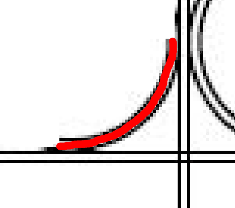

1) I doubt that there's a canned formula in existence anywhere that would do a decent job of this particular situation given the boundary conditions.
2) The perfect moment and torsion restraint at each end of each quadrant segment will tend to lock things up pretty good.
3) Torsional effects should be pretty much irrelevant for a bar section this stocky and this short.
4) To the extent that the bar warps at all, that will likely devolve into a torsion couple formed by two opposing arches.
5) LTB is a non-issue at the proportions being considered.
5) I'd just take the plate segment shown below, straighten it out, and run a normal beam Von Mises check on flexural stress + shear stress. Maybe deflection if you care. For anything fancier than this to be of any legitimate worth sounds like FEM to me.
