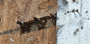

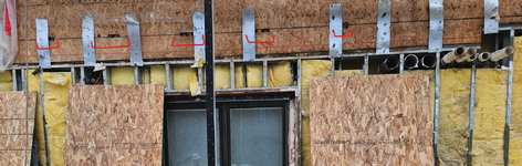

I am working on an existing building with three levels of elevated PT slabs. The building was built circa 2000 using unbonded PT tendons. The contractor is currently completing the strip portion of a full strip & reclad and discovered some PT tendons that appear to have never been cut or at least not capped during construction. The OSB sheathing at the third level was cut around the tendons and the tendons were butted up to/encapsulated in the exterior stucco. Has anyone seen a situation like this before? I was thinking about having them shear cut, cap, and grout the tendons for water protection after I was informed over the phone of the situation. However the damage looks more significant now that I have photos. The structure has performed fine for the last 25 years and the planned repairs to this building are mainly architectural, not due to structural distress. I'm wondering if we can arrest the damage at its current state without an intrusive repair and essentially abandon the tendons after cutting, cleaning, capping, and grouting. I worry about getting a good seal with the cap/grout given the damage to some of the wedge anchors, as well as the fact that there doesn't really appear to be a pocket to cap and grout.
Normally I have had tendons cut within 72 hours of the pour, followed by grease capping and grouting within a day. Are there any unintended consequences of cutting and capping the existing tendons now? Any thoughts to avoid an intrusive repair? My PT repair experience in the past has been all in new construction during CA. See attached photos for reference where the holes in the OSB are marked in red.

Something seems dimensionally amiss here.
Did the slab edge get constructed incorrectly, such that it had to be 'chipped' back because there is no PT pocket and the OSB sheathing is hard against the PT stressing anchors.
Do you have a photo of a length of slab edge AFTER the OSB sheathing was removed to check the slab edge between PT anchors?

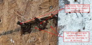

There is a significant strand tail remaining to the tendons - if this was my project I would be doing a few (min 10% sampling) lift-off tests to check the tendons before closing it up with greased end caps, sheathing etc.
I will add that current PT systems (fully encapsulated PT anchorages and end caps) work well as a system, but to adapt an encapsulated end cap to an UNencapsulated anchorages is difficult - there is nothing to grip/bond to.
Back in the day (late 90's/early 2000's) a company called TIGER INDUSTRIES developed a greased end cap that did fit over a trimmed strand tail via a snap ring. Unfortunately they are no longer manufactured (although I still have several thousand that I use on PT repair projects).
If a greased end-cap cannot be made to work, I would be steel wire cleaning the exposed anchorage, wedge face and strand tail and apply two coats of epoxy before a cementitious patch.

I haven't seen this situation at the other, lower level slab edges which leads me to believe that they hopefully only screwed up this level (or elevation). The chipping back is an interesting observation. The contractor is pulling off OSB today so I should be able to get some better observations and photos later today.
Testing does seem like a good first step in this case. Looks like I'll be reaching out to a PT sub soon.
