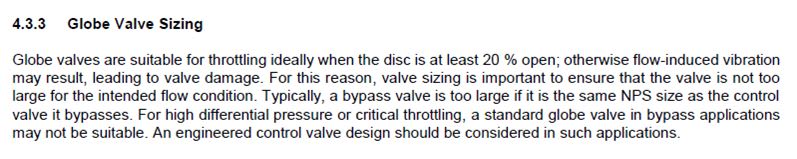

- Check API RP615, snip below
By that respect no "industrial valve" manufacturer will guarantee control-ability of bypass valve for stem travel below 20%
Hence, no Cv will be provided or even measured in the first place for the whole range. And only at 100% opening

Would suggest, check the control valve operation range. Let say 35-60%, and then check that 60% Cv value, let say 13. Then size the bypass valve at 100% opening with that Cv value, in this case can be 1" as per link provided by MFJwell. Don't use the 100% Cv value of control valve
