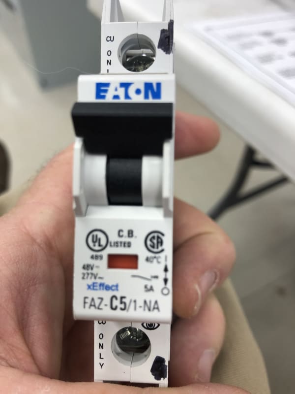

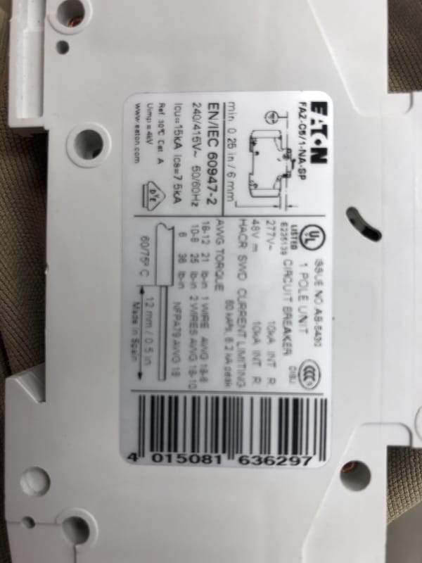

I understand you are not interested in
DIN rail, but I just pulled this out
An RTU cabinet about 5 mins ago.
It clearly has a 48VDC rating on it.
BTW this units have a hair trigger and will
Trip if you sneeze wrong.

If you don't like DIN rail mounting, you can use a Square D "QOU" style breaker. They are lug-in, lug-out and can be mounted with clips and screws (or DIN rail).
QOU miniature
circuit breakers are rated in the following UL 489 voltages, as shown in Table 3:
• 120/240 Vac
• 240 Vac
48 Vdc
• 60 Vdc
They don't go up to 175 A.

These are 150A @ 48Vdc
