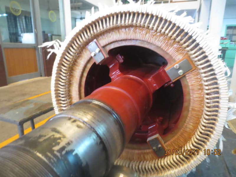

Dear All
Recently , during periodic maintenance we observe two burnt spots on edge of the commutator bars (near the risers). so we worried and perform the electrical
tests and find out the results as below : (Motor spec: DC Motor 930 kw - 1500 RPM - 800V - 1227A)
1 - Insulation Test : V(test)=1000v - result : IR(15 sec ) = 4.74 G ohm and IR(1 min )= 12.7 G ohm
2 - Measurement of Resistance = 1.1 m Ohm
3 - Measurement of Inductance = 6.6 micro H
4 - Surge Test : V(test) = 2000 - result = OK
some people declared that "Equalizer winding of the rotor " is damaged and rotor must be rewind completely and the others proposed that repairing of the damaged spots is possible and it is not necessary to rewind complete rotor . it is notable that the commutator is not V ring type and spare rotor/motor is not available .photos is attached
What's your Proposal ?
thank you for your kind ideas .

The commutator appears to have a normal wear on its surface. Nothing in your original post indicates there was/is a running problem with the motor.
Nicks, and burn marks show up all over pieces of equipment during their operating life span. Based on the photo alone, the motor looks fine.
One test not mentioned, and quite important is a Bar-to-Bar test.
Perform a Bar-to-Bar test on the armature. If a consistent pattern (what ever it may be) is not observed around the entire commutator, rewind the armature.
John
I may be wrong but for me it looks as though the arcing is restricted to the wire termination area, if it was a winding fault I would expect to see evidence across the commutator from the brushes arcing.
I wonder if it's possible to clean out the slot between and re-insulate it.
Maybe the solder needs re-freshing.

1- Motor was in operating condition and working fine till we find out the burnt spots during periodic maintenance .
2- the question is "is it possible to repair the damaged spot without rewinding the entire rotor ?"
3- is it possible to run the motor at the current condition ?
4- what is the root cause of the problem?
If the motor was operating “perfectly fine” before it was taken out of service, there’s no reason
to believe it would not work after returning it to duty.
As roydm suggests, “…if it was a winding fault I would expect to see evidence across the commutator from the brushes arcing…”
The commutator is likely tig welded so “resoldering” would not be a remedy.
The marks look cosmetic to me. Puffs of brush arching smoke and dirt adhered to the insulation surface.
Have you tried rubbing, or cleaning them off with a rag?
Not discounting that there could be an electrical issue with the winding, “but” a bar-to-bar test would
provide valuable information in making a conclusion or decision.

Is it possible that someone dropped a wire or tool onto the commutator when the motor was running?, possibly while dressing the brushes?
Try cleaning the spots with some fine sandpaper to see if this is only surface damage.
It is hard to say definitely but that strikes me as the result of a one-time flash rather than an ongoing condition.
I see similar damage when someone drops a hot wire on a grounded surface or grounds out a hot terminal with a metal tool.

How did some people decide the equalizer winding is faulty? Was there any sparking during load? Majority of the equalizer windings are buried under the armature winding either on the commutator side or on the opp-commutator side. It is very rare that the equalizer winding alone can be repaired.
Do a bar to bar resistance test. If the resistance values change by more than 10%, then you have a problem in the armature and/or equalizer winding.

we will do bar to bar resistance test and check the results , so if we find out the acceptable result , is there any suggestion for make a safer operation ?
again : is it possible to repair the damaged spot without rewinding the entire rotor ?
Dear All
we change the repair shop contractor . he check the rotor completely and perform bar to bar test . it was ok ( 0.101 to 0.098 ohm )
he believe that the burnt spot is related to moisture which has been inserted to space between bars and caused to damage the insulation bandage .
so he want to check the bars visually , hence he removed the burnt insulation material . it was ok .
he said to us the insulation must be repair again and also insulation bandage .
