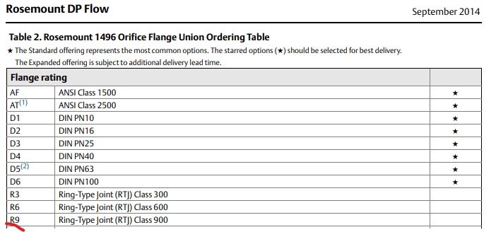

Dear team !
Can you please advise what does "RF R9 flange" mean ?
I can understand RF (raised face) but I couldn't have found any information on R9 in the ASME standards
Thank you🤝

I agree, more info is needed. It does however seem like Emerson uses this description in their Rosemount product portfolio (not endorsing here, just relaying info my coworkers showed me). As you can see they specify R9 as an RTJ. "RF R9 flange" does seem like an incomplete description, or at least a confusing one.
It could mean an RF class 900 flange to differentiate from the RTJ type listed above?
I've seen ref to Emerson as well.

Ah,
Would have been good to have that included in the OP....
It certainly isn't an R9 O ring then.
Or a class 900 flange.
Or an RTJ type flange.
