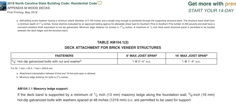

That chart does not look familiar, may be a NC only addendum...
Personally I feel like supporting deck ledgers from veneer (for in plane load and gravity load) seems like a reasonable approach in most cases, especially if load perpendicular to the wall is addressed separately with thru-wall ties of some kind.
Prescriptive codes like the IRC, with some exceptions, seem to disagree though.
