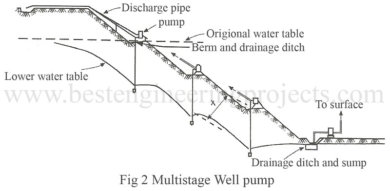

You did not provide alot of information here. Having experience in KSA , my preliminary points are ;
- The open pit study shall be carried by an geotechnical group having local experience,
- As a starting option; open pit excavation with side slopes may be considered,
- the ground water shall be lowered with well point system , ( multi stage well point system )
- the sides with benching should be considered .
When you write ' multi stage well point system '' and search the web, one of the outcomes ;
