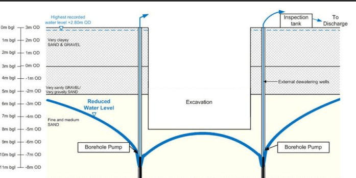

I think it is a stability problem. As soil is to be removed/excavated from a balanced system, and the ground water pressure will cause instability in the imbalanced system. The drawing below depicts excavation and dewatering in the granular soil, that may not fit your situation, though similar.

Don't take pump failure lightly. You can see from the sketch above the water profile during dewatering, when pumping suddenly stops, the water will try to return to the equilibrium state. In doing so, a quick, semi dynamic, condition is created, which will do two things - 1) washout fine particles behind the sheet piling wall and create voids/pockets behind the wall, and 2) create heave in the excavation, that causes disturbance on the pit floor and weakening the underlying soil. Thus, when excavation resumes, there is more mess to deal with. Not to mention the delay of construction schedule.
