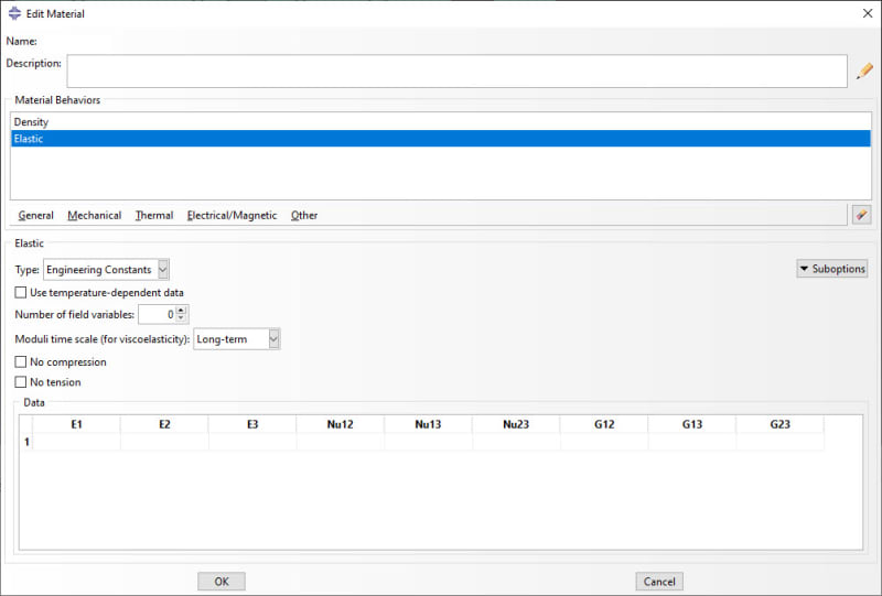

Define stiffness in two directions?
rte4563
Sep 28, 2022
40
I have a rubber brick which has a given stiffness (and a given Youngs modulus for its width*length*height) in the horizontal and vertical direction.
Since the Youngs modulus is dependent on the dimensions of the rubber brick, I can't get both the vertical and horizontal stiffness to be correct, only one. Is there a way to define a Youngs modulus for vertical direction and one for horizontal direction? Making the material data not Isotropic.
Yes, orthotropic elasticity is of course supported in Abaqus.
Easiest way would probably be to define the:
E1, E2, E3 (Youngs moduli in global X,Y,Z direction)
Nu12, Nu13, Nu23 (Poisson's ratio in global X,Y,Z direction)
G12, G13, G23 (Shear moduli in global X,Y,Z direction)?
when I have vertical/horizontal stiffness and the W*L*H of the rubber bricks?
Yes, this Engineering Constants format is definitely the easiest one to define.
