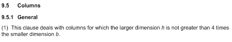

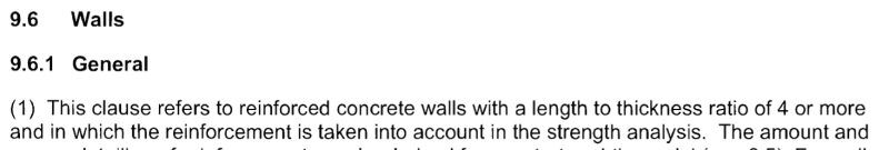

I noticed a grey-zone of the definitions of columns and walls through dimensions in Eurocode.
The clause 9.5 BS EN 1992-1-1:2004 in Eurocode, describes the following,
That means 1:4 dimension ratio = a column
That means 1:4 dimension ratio = a wall
For instance, a concrete element which has a 1 units x 4 units is both column and a wall according to Eurocode. A schrodinger's cat situation or I'm misinterpreting the definitions?
Or else, are the proper definitions of what columns are and walls are defined properly elsewhere in the Eurocodes?

If it's exactly 4:1, you should satisfy both sets of requirements if you're unable to judge whether it's functioning as a column or as a wall.
Dear Pretty Girl7 (Civil/Environmental),
The short answer if we strictly follow EC -2 is, we should look clause 5.3
5.3.1 Structural models for overall analysis
(7) A column is a member for which the section depth does not exceed 4 times its width and the height is at least 3 times the section depth. Otherwise it should be considered as a wall...

Thanks a lot, this was the exact clause I was looking for.
