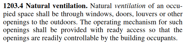

I think it would be outdoors but that's my opinion. I looked in ASCE 7 and IBC but there's no definition. I found this in IBC
which could be interpreted that a "missing" wall makes it outdoors, or maybe a missing wall is an "other" opening to the outdoors.
Maybe Ron will weigh in on this; he probably knows of some code that defines it. [ponder]
