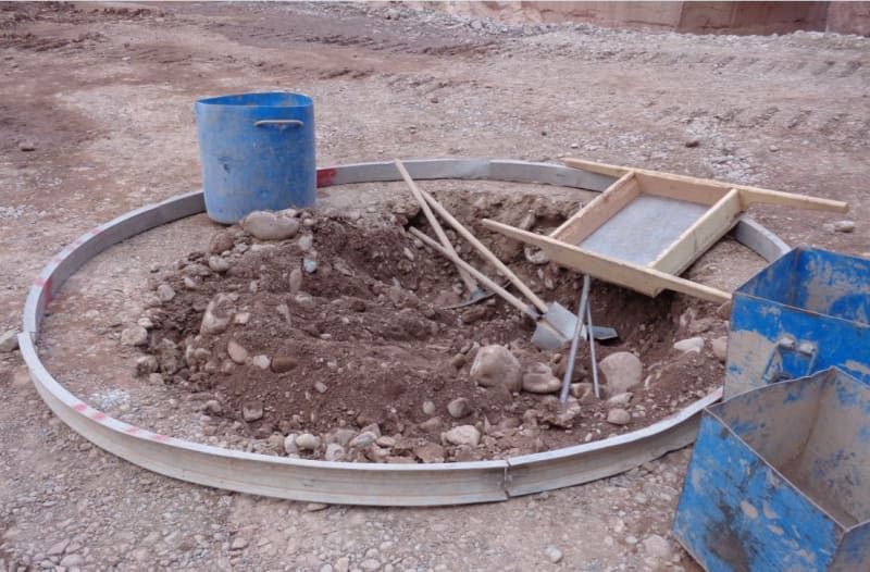

I am not sure if you are doing this at the base of a hole that has been dug to 2 m depth or ? If it is one that is done to 2 m depth and you are testing the base, you will need to make sure that the sides meet safety requirements as this is deeper than 1.4 m. if the rock size ranges are large - say nominally 0 to 300 mm, then the methods suggested by our mate would not really be applicable and you will need to use a water replacement method such as ASTM D 5030. Remember that the diameter of hole is given in D 5030. For a max size of 300 mm, you need a 2 m diameter hole; 450 mm requires 3 m diameter. Basically the diameter of the ring is 6 to 7 times the maximum stone diameter. There are depth requirements too. So, a lot depends on the maximum size of the stone. Bigger stone requires as larger diameter ring which means if you are doing this at a depth of 2 m, then the hole really needs to be big to accommodate.
Try to keep the hole as vertical as possible. Keep all material removed for determining the mass. When the hole is clean, you would would place a thin plastic film in the hole. Keep it "loose" so that when water is placed the film can deform into the crevices that will be present. D 5030 wants you to "mortar the sides smooth" - which is just not done. Prior to digging the hole you will need to determine the volume of water "in your above ground ring to subtract from the total water used. It is pretty intuitive.
Below gives you the "start" of a large scale water replacement test
I love the picture. Good tool set. Now the OP needs to consider that a sieve analysis of the material, Based on the small cobble sizes--ALL of the material, is next on the list of activities. I would also recommend that quite a few moisture sample be taken during the excavation process.
