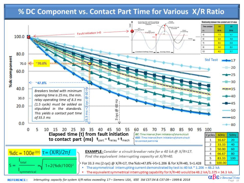

I can see on these curves for an X/R ratio of 17 and standard 45 ms curve, about 70% de-rating is applicable. Shouldn't that be 100% for standard calculation?
To follow the original post and to respond Power0020 question, below is re-edited graphical illustration
of % DC Component vs. contact parting Time for Various X/R ratios.
At difference than the previous graph, the horizontal axis is the "Elapsed time (t) from fault initiation of the breaker contact part in ms (sum of the operating time of the breaker and relay)
This illustration includes an example of a circuit breaker rated for a symmetrical interrupting current of 40 kA (although not explicit in the nameplate, it is understood that this rating is a standard X/R=17 equivalent to a time constant of τ = 45 ms and asymmetrical current of 48.2 kA).
The breaker short circuit breaking capacity was derated from 40kA to 34.3kA (14.32%) to operate in a system with X/R= 35 equivalent time constant τ=93 [highlight #FCE94F][ τ = (X/R)/ 2Π.f][/highlight]
Notice that the total parting time is the sum of the breaker tested minimum opening time plus the minimum relay operating time [highlight #FCE94F](ttotal = tBkr Mech + tRelay)[/highlight]. Modern SF6 Bkrs often tBkr Mech= 25 ms and relay min. operating time of 8.3 ms (1.5 cycles). Safety margin is usually recommended around 20% should be added.
