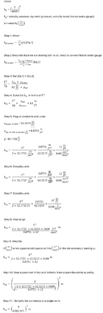

Derivation for 4005 in velocity pressure equation imperial units
M_J_S
Nov 11, 2020
1
Hi.. I was a bit lost trying to follow this thread, and I've been unable to find another clear / comprehensive derivation.
I've put the following together.. and would appreciate any feedback on making it clearer for my (and anyone else's) future reference.
Thanks for any input!
