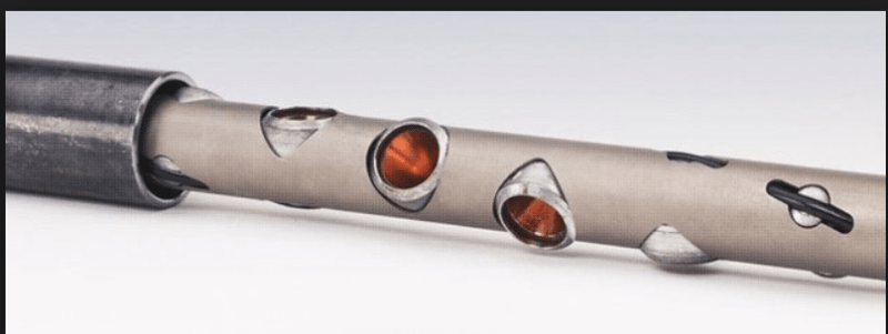

I want to create a feature cut. this cut repeats every pitch 4 in, 60 Deg like in a helical path(not exactly). here cant use pattern, need to create these cuts as a separate feature. pls see below image.

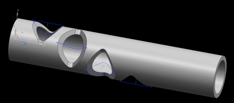

I think something like this:
Between every sktech is that same dimension (in Z axis), and that same angle - 60 deg.

yes, dimension in z axis i.e pitch remains same. and all sketches are same dimensions.
can you please share the model or explain how you got that? i want it in such a way that changing dimension in first sketch should update in all other features.
Thanks a lot MANox. its really helpful.
