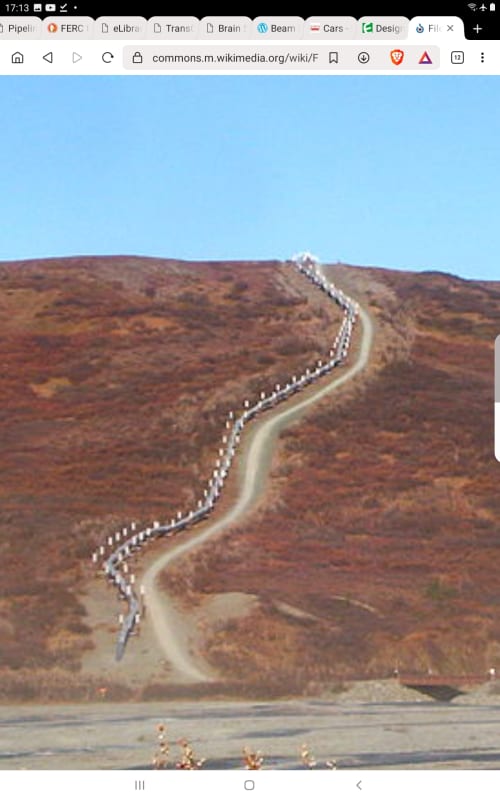

Lot of the Alaska Pipeline is above ground.
