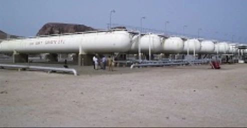

Anchoring, storage racks, gas cylinders gave me this picture,
But apparently you are talking gas bottles, medical, welding, scuba tank stuff.
I would not use the term anchoring for those types of cylinders, since they really are never anchored (like with anchor bolts), but generally only set in place.
