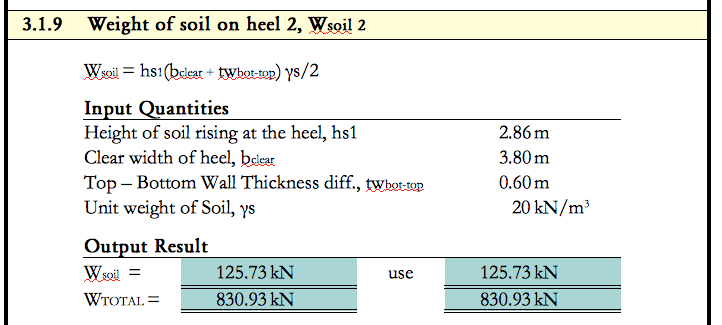

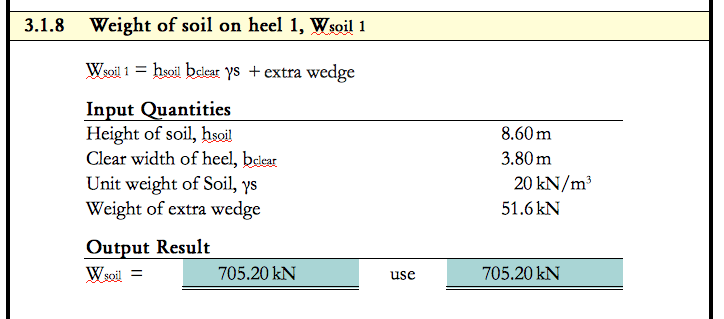

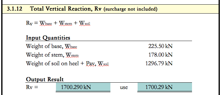

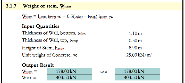

This is the design of a 10m cantilever wall which i was assigned to check and confirm.
From my calculations i found that the wall is failing in sliding in the seismic loading.
I want to take this step by step with you guys just to get your advice, since i am in a bit of a conflict with the engineer that actually designed this.
Below are my own calculations.
As you can see i am using Rankine for now since i am not sure how to apply coulombs on a cantilever wall.
My main concerns about the parameters used are:
1) Angle of friction of backfill - too high, they are not conservative at all
2) Angle of friction of base soil- too high, they are not conservative at all
3) Angle of ground rising above wall - this angle may not be achieved and/or the soil at the edge will not be compacted enough due to the difficulty of the slope.
4) Unit weight of backfill is a bit conservative so that one is ok
I will first carry the calculations with what they assumed for the parameters and then start making changes.

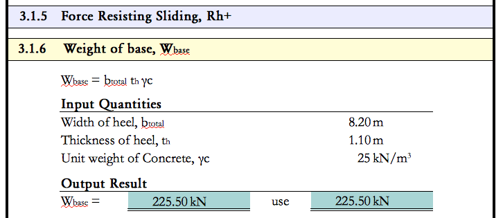

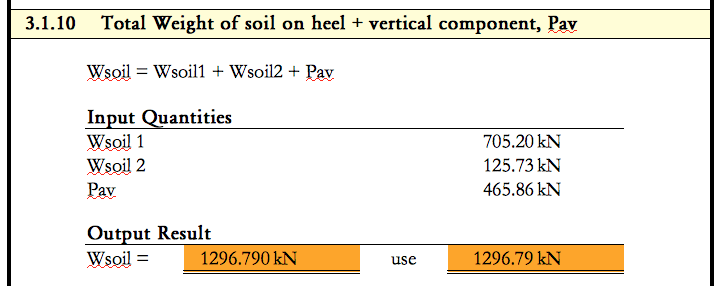

First step is the Total Sliding force shown below
My concern in the calculations below is the vertical component of Pa, Pav. This makes a big contribution to the sliding resistance.
I have also noticed that this value can greatly decrease if the angle of the ground rising above the wall decreases even by 13 degrees.
Pav is greatly depended on the slope of the backfill, do you think i should be conservative with this and reduce the value?

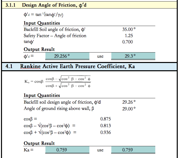

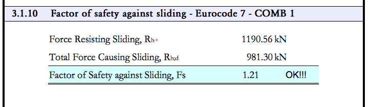

The initial calculations i posted above do not take into account any Partial factors of safety
Therefore below i have posted the results taking into account Eurocode 7 Combination 1 and 2 partial factors
Eurocode Combination 1 uses a partial factor of 1.35 on Permanent Unfavourable loads (ONLY), in this case "The Total Horizontal Thrust from Soil, Pa;dh"

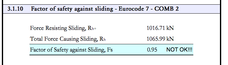

Eurocode Combination 2 uses a partial factor of 1.25 on material properties (ONLY), in this case, the angle of friction of the backfill soil and angle of friction of base soil.
as a result combination 2 produces a much bigger value of the Rankine active earth pressure coefficient
Eurocode 7 - combination 1 - Results
Eurocode 7 - combination 2 - Results
As you can see above the wall is failing in sliding in Combination 2.
Furthermore, Eurocode 8 which is for seismic design suggests using an additional seismic load together with Eurocode 7 - Combination 2 partial factors for materials
Therefore imagine if the wall is failing now, without a seismic load, imagine what happens when i add that.

You are right about the Partial Factors for Actions, EC8 specifies a partial factor of 1.0 for both permanent and seismic or Accidental loads.
However EC8 specifies a partial factor of 1.25 for materials (eg. backfill soil angle of friction). This directly affects the Force applied on the wall.
