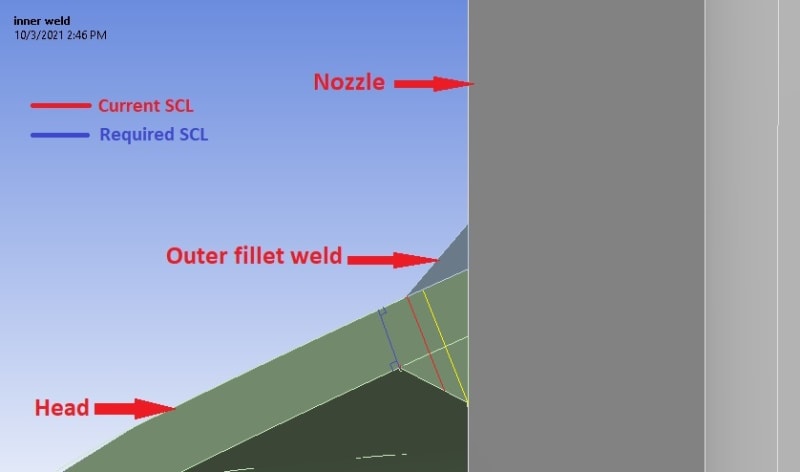

I am designing a pressure vessel as per ASME Div.1 Edition 2019, the client requested that the vessel has a rectangular nozzle with filleted corners, and a flat door to close it against a rubber air tight gasket, during the entire vessel design phase I haven't faced any problems except when I started designing the head and that hugely large, weirdly shaped opening, a detailed analysis of the door, door frame and adjacent shell is required which after further research, I found out that using design by analysis rules of div 2 (as indicated by Mandatory Appendix 46). I created a 3d Model for the head and the doorway to perform the FEA on. According to div 2 rules the stress classification line should be perpendicular to both the inner and outer surfaces of the head (aligned radially) however, the line starting at the toe of the inner fillet weld joining the nozzle and the head and ending at the outer weld's toe is not perpendicular to the two surfaces, as both welds have the same size; and according to ASME PTB 3 2013 there should be a stress classification line at the toe of the weld. the only way I see is to make them of different (and probably bizarre) sizes so the points create a radial Stress classification line which I can use to find linearized stress results. Am I over thinking this? is it ok if the stress classification line is not exactly radial? is there anything I am missing? I am actually in need of any help to find out whether I have been doing right with this project or not.

I would do two lines.
The blue line is correct.
The red line should be perpendicular and run through the weld. It will provide an approximate result which will require judgement to interpret. It's the blue line that will be the basis of the result.
But I suspect that the corners your door geometry will require an Elastic Plastic Analysis.

What exactly do you mean by "run through the weld"? do you mean like the red or the yellow lines in the attached photo? or do you mean something else?

Like the red line but that just looks odd. Perhaps also try the red line but not through the weld. I think the mathematical linearisation integration in ANSY will spit out garbage for the red line. You will need to informally linearise with your own judgement and plenty of additional margin. Perhaps by inspection you will find that the bending stress at the top of the red line is less than the blue line.
Perhaps your stress distribution line will be squiggly rubbish making this an Elastic Plastic Job.

I also think that red line looks weird and will definitely consider not running it through the weld. I just think that technically any nozzle in a formed head that has an inside projection and welded on both sides should -especially if it's a hill side nozzle- face the same issue (with varying degrees depending on the head thickness, weld size and location of the nozzle in the head) in determining the orientation of the SCL and just want to know what others will typically do in such a situation. do they just connect the weld toes? Is there a certain tolerance limit to how correct the SCL should be oriented?
