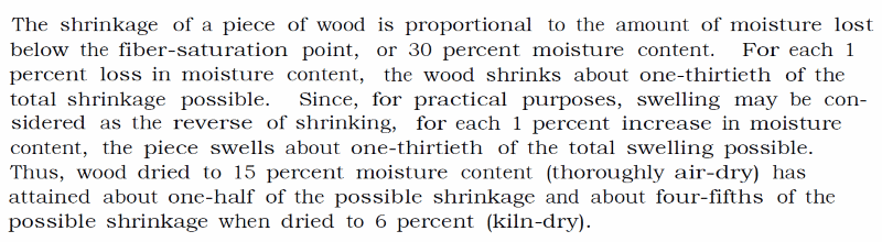

I can put a belleville washer under the nut to take up the space and the bolt will not be loosen. Is there any simple way to determine the maximum and minimum dimension of the 6x6 wood (spur or spruce)? That can help me to size the belleville washer.

The maximum content is easier, it can be soaking wet as it is underground by about 1 ft deep. The minimum moisture content is harder to get, in a very dry month, may be 5 percent. The wood can either be spruce or fur, no choice really. The wood is treated and from lumber yard, don't really know how dry they are.
If it is underground, you will never get below 15 percent. Air dry is 15 percent, you need to provide supplementary heat and lack of humidity to get below that. The interior of most houses have their wood moisture content running between 10-15%.
Honestly, I feel you are making a mountain out of a mole hill. What is the application? Do you really need to provide belleville washers? Can the structure tolerate slightly loose bolt holes?
I like to keep the joint somehow tight. I like to know the ball park for the maximum shrinkage and swelling possible for 6"x 6"x 6 ft long wood.
The shrinkage in length is negligible. Max expected shrinkage in the 6 dimension (I assume that's a 6x6 nominal so 5 1/2") would be maximum 0.22" total. And that assumes a worst case of 30% moisture content at time of install (highly unlikely) and an a lowest moisture content of 15% (also unlikely in this case being below ground). Like I said, mountain out of a molehill. I would expect the actual installation moisture content to be between 15-20% for treated material (as when I buy it, it always seems rather wet) and an average operating moisture content similarly between 15-20%, therefore the expected shrinkage would be near zero.
