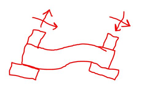

Hi
I recently received a request to perform a modification design for a telecommunication tower foundation. It's a four leg, 80m tower and
the base reactions from the tower analysis are:
1914.61 kN Max compression
1665.27 kN Max uplift
27821.77 kNm over turning moment
756.12 kN Base shear
574.36 kN Tower and appurtenance weight.
Currently the tower has isolated footings beneath each leg (please see sketch attached) and these fail massively in uplift. Unfortunately the tower site has a number of constraints both within and outside the fence that make simple expanding the foundation impossible. I am hoping to counteract the uplift by connecting the foundations using a beam. IEEE standard 691 mentions this as a viable method to increase the capacity of tower foundations, I checked the web and apparently it is also approved by Korean standard DS 1110. Unfortunately, I haven't come across a reference that gives specific guidance on how to analyze/design such a system. Is there any guidance you can give in this regard and perhaps any references you can point me to?

Obviously it isn't a method that is commonly used, but as I stated, it is mentioned in some engineering codes primarily IEEE 691 which I happen to posses. From what I have read, the idea is that the beam will transfer a downward force to the upward leg due to it's own weight and the weight of the soil around it. So in regard to the uplift force it simply acts as a counter weight. Here are the issues, that have got me confused:
Firstly, just like you, I thought that the beam should be designed as a cantilever supported at the downward leg and resisting the uplift force but according to the documents I read, it should be checked for two conditions, fixed on both ends and then fixed on one end and pinned on the other. For the fixed-fixed case, this would suggest that there are certain moments about the end of the beam, but where do they come from? The beam isn't directly loaded by the tower base reactions and it isn't suspended so it's own weight shouldn't be an issue. The only force I can think of that can cause these moments in the tower base shear.
Secondly, since we will be tying everything together, shouldn't the system created be able to counter the overturning moment? I'm of the view that since all the individual footings will no longer act in isolation, the system should act like a pseudo mat foundation and resist the OTM but no mention is made of this.
Lastly, they state that the beam should be stiff enough to resist rotation between the footings it connects but no mention is made of how to go about designing for this condition.

Connecting beams will increase foundation capacity, but not in a way that will help with this project. Connecting beams are typically used for electrical transmission towers in poor soil (e.g. swamps & marshes) where the soil does not provide sufficient lateral support for independent leg foundations. Connecting beams make a stable structure out of the individual leg foundations.

For the fixed-fixed case, this would suggest that there are certain moments about the end of the beam, but where do they come from? ... The only force I can think of that can cause these moments in the tower base shear.
I agree with your base shear assumption and see it as shown below.
Also per the model below I think. When all is said and done, you'd like the bearing pressures under each of the footings to be fairly uniform.
I have know idea if this mechanism addresses your OT demand but I'm fairly certain that it is the model intended in the literature that you've been reading.
I think your model is correct Koot.
However I think there’s still an overall instability here as the base is simple not heavy enough.

In regard to the proposed solution, like I said, it should provide so additional uplift capacity and I would still like to find out how to go about it. Information is rather scarce though. In regard to the proble at hand, I have decided to cast a single mat that incorporates all the isolated foundations. 12.5m x12.5m x 0.8m and enlarge the foundation column to 1mx1m so that I can incorporate my own steel into it. Not sure if this will fly with the client though.
I think the same, simplistically you need a lot of concrete to resist the 1665kN uplift locally to the legs, sure you don't have to provide it there, but any concrete located closer to the compression legs has more limited benefit. For the compression force to benefit the stability you need a large enough footing to start with. If the compression leg force acts beyond the centroid of the reaction on the soil then it's still destabilising the footing.
1665kN/(0.9x24kN/m^3)= 77m^3 of concrete. This is a solid block of concrete 4.25m x 4.25m x 4.25m, i.e. a lot of concrete!
