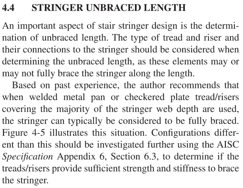

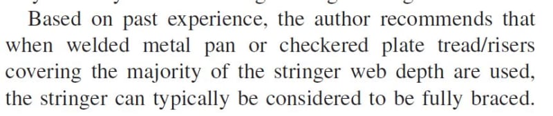

AISC Design Guide 34 mentions plate stringers in passing. Then it has commentary on the unbraced length related to treads. Check out Section 4.4 of DG 34

They don't deal with plate stringers directly... but consider fully braced...
I'll use the depth that is fully braced, ignoring the little strip at the top and the bottom where the plate isn't braced by the stair treads. thanks

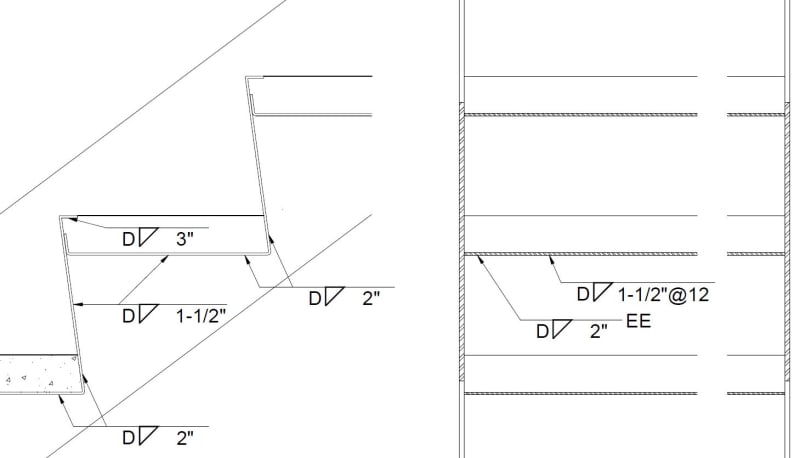

I've checked the design and the 1/4" plate stringer works from a strength condition. I was planning to weld the pans to the stringer with 1/8" welds all along the length of the connection. I was thinking that this might be excessive and have decided to do the following. Does anyone have information on the reqirements required to prevent the stringer from buckling?
I've limited the strength of the stringer to the buckling capacity of the plate between the two adjacent nosings. I think the fully enclosed pan provides a very rigid 'diaphragm'. I think the proposed welding makes the connection of the pan to the stringer very rigid. since most of the weld is in the areas where it is likely needed. The buckling strength resistance between the nosings is about 7.5ksi.
Thanks GC... The NAMM one is common with channel stringers, but I'm not comfortable with it for plate stringers. This is the first plate stringer I've done... and just figguring out how to do it. I thought for intermittent welds, the length had to be 1-1/2" min. The spacing can be 12" for compression members and 18" for tension members.
