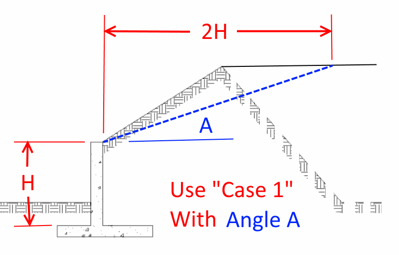

Refer to the linked picture. I am designing a retaining wall to support a salt pile. I am familiar with the procedure for calculating the force on a wall with sloped backfill but the problem here is that the salt being stacked at the angle of repose gives me a very large Ka value (case 1 in attached image). The actual condition of the backfill is constrained to "case 2" from the attached image due to geometry of the site. I would assume that the force for a pile that slopes to a peak is less than the force for a pile that slopes infinitely off to the distance. Does anyone here know how I would go about calculating the force on the wall in "case 2"?

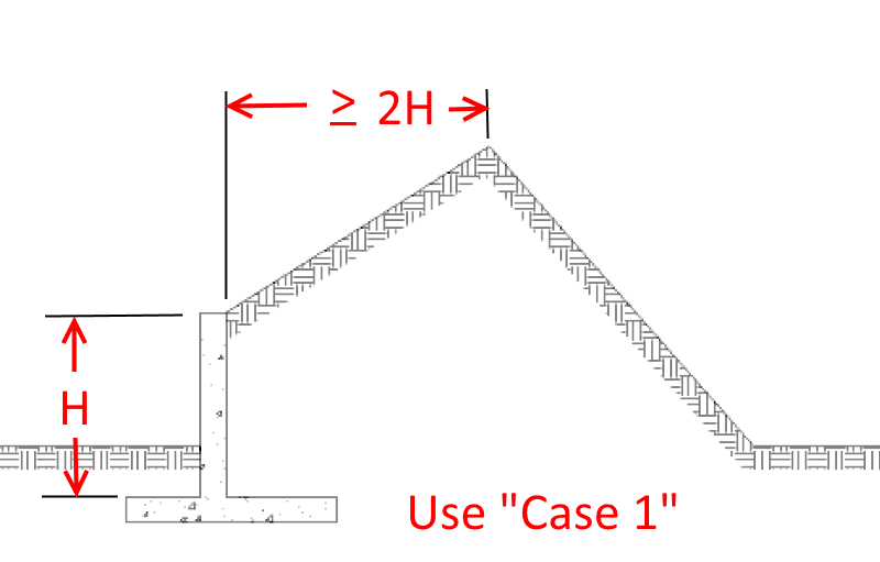

The (horizontal) zone of influence of sloped backfill on a retaining wall is sometimes assumed to be twice the total height of the wall. If the top of the pile is at least that far from the wall, calcs for "Case 1" are reasonable:
If top of the pile is closer, assuming the backfill to level off at the high point will give a lower, but still conservative answer:

I would design for the peak height. Eg if the pile is 30ft high I’d assume 30ft rectangular block of soil.
Of if that was too excessive I’d average the soil height in the zone of influence.
