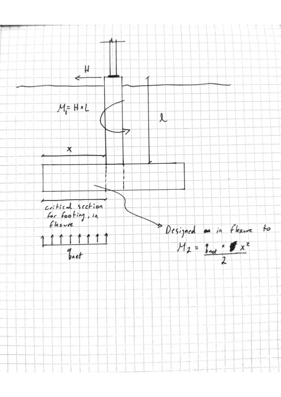

I have been reading about the design of shallow moment resistant footings using "Foundation and Anchor Design Guide For Metal Building Systems" by: Alexander Newman
The author discusses the design of the foundation to lateral loads.
Horizontal thrust onto the foundation from a column above is only used to design the foundation wall below to moment and shear (M = force * depth of wall).
However, the author does not design the footing for this moment.
Isn't the moment transferred from the foundation wall to footing below? Should it be considered in the design of the footing?
The footing is only designed for moments from net earth pressures. I find it counter intuitive that we don't design the footing from the moment coming from the wall above.

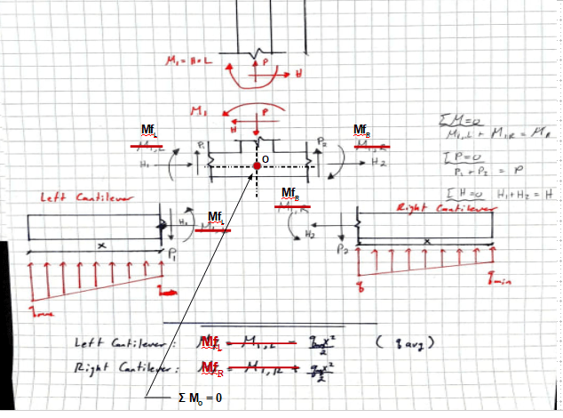

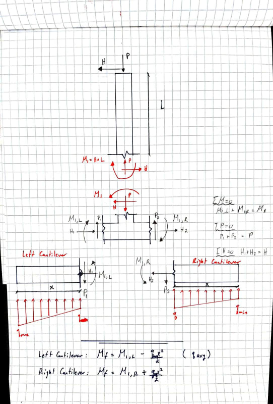

r13 and RWW0002, please see below.
The author does not design the spread/strip footing to moment M1 in my figure.
EDIT: RWW002, now that you mention it, eccentric moments from the foundation wall will influence the soil pressure distribution under the footing. Is that how we "capture" moment M1 in the flexural design of the footing?
I think what RWW0002 describes is what the author does. He gets the soil pressure with the thrust force in the "Proportion the Foundation" section then uses that to design the base.

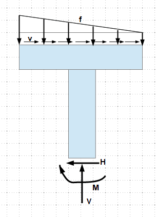

Does the sketch below answer your question?
And when you detail your wall to footing reinforcement, make sure that it fully anchors and provides the fixity for the walls. In many cases, just hooking them and extending them to the bottom of the footing is not sufficient.
I agree with everyone else, either you take care of the horizontal component by tying the top of wall into a SOG or you design the footing for the full moment from the horizontal force.

@r13: Yes I agree with you. I have attached a new figure, explaining what I am trying to explain.
M1 is the moment from the external forces, and my understanding is that it is transferred internally to the cantilevered footing below, as per internal stress equilibrium in my figure.
I also understand that this moment causes a non-uniform soil stress distribution below the footing.
That being said, there should be two sources of moment acting on the cantilever: the first from the external moment, and second from the soil pressure.
This is what I am not understanding - why is the internal moment M1 ignored in the design of the cantilever?
Because it causes the soil pressure moment. You don't need to design for double the moment. If the applied moment wasn't there, the soil moment wouldn't be required.
Note M1, MfL and MfR are all internal reaction at the critical face.
@Jayrod:
Ahhhh I see it now.
There is a balancing moment from the soil distribution below the footing.
The centroid of the footing pressure is not along the centerline of the column, and that will cause the "restoring" moment for equilibrium.
This moment is equal to M1 from the lateral force on the top of the wall.
That makes sense.
So, my figure above is in correct. It would be correct if it showed a uniform soil pressure below the footing, otherwise I am designing the footing for 2 * M1.
