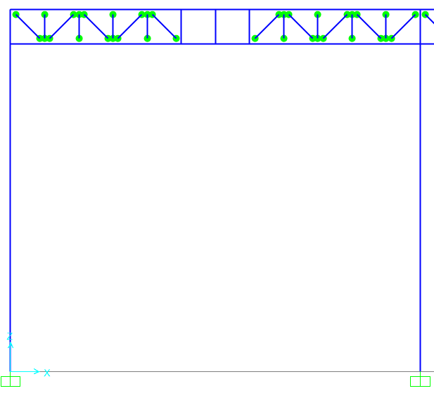

Hi all! I am designing a special truss moment frames in SAP2000. I have pinned the ends of all truss members (see attached) and i think it should be like that. When I ran the model it gives warning message saying structure is unstable or ill-conditioned. Am I doing it correctly?
Please recommend if you know any papers or worked out example related to STMF.
just a 2d model? or is it 3d? I'm not personally familiar with SAP other than to know it exists.
Why do you not have diagonal webs in the middle of your truss? That is ill conditioned. If you're eliminating diagonals, then the vertical web to chord connection must be fixed for it to act like a vierendeel truss.

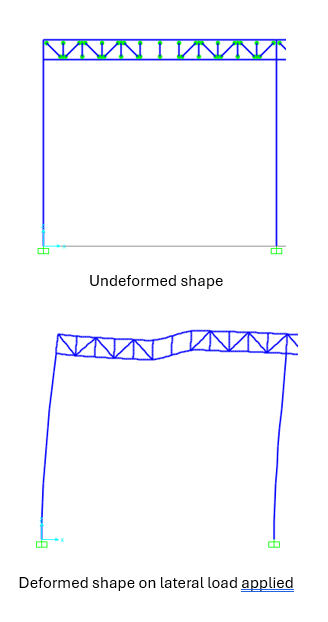

I fixed it by changing couple of things in my model. It is a 2D model. Yes I am designing it to act like a vierendeel truss. Why do i need to have vertical web to chord connection fixed? Can you please elaborate or provide some references if you have any?
because that's how a vierendeel truss works when considering only vertical webs. Now that you've added chord continuity to your model, it doesn't appear necessary, but you'll note the added deflection/flexibility in your truss at that location. Essentially without diagonals, or the webs being fixed to the chords, your top and bottom chords will need to be designed for an unbraced length equal to the length between diagonals. The web to chord connection being pinned in the centre where you only have verticals would allow the web to just fold over if it tried to restrain chord buckling.

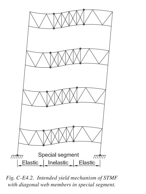

OP said he was designing a Special Truss Moment Frame. Those require a special segment in the middle of the truss where deformation occurs for seismic design. I've never personally designed one, but the reasoning is there.

I can't remember how SAP deals with this. But in other programs, if you have so many members framing into a single node, and you release all of the member ends, the node itself becomes unrestrained for rotation. Ensure that you have adequately restrained all the out of plane translations and rotations for each node in the 2d model.
For those commenting on the lack of diagonals, please refer to the design guidance for special truss moment frames in AISC SDM or other similar reference. The OP referenced this specific system in the post, and the lack of diagonals in the special panel zone is very much the design intent of this seismic system.
If you want special zone with Vierendeel trusses then I would model the top and bottom chord as continuous (or at least continuous up to actual shear splice locations), and the webbing the special zone should also have fixed ends.
I made the changes on my model. I think the webbing on special zones have fixed ends to develop the plastic hinges, correct?

Start with section E4 of AISC 341-22 if you haven't reviewed that already: Link. You can use vierendeel action for the special segment if there are no significant gravity loads there. Other wise, you truss the special segment which, of course, limits the spiffy ability to accommodate mechanical runs there.

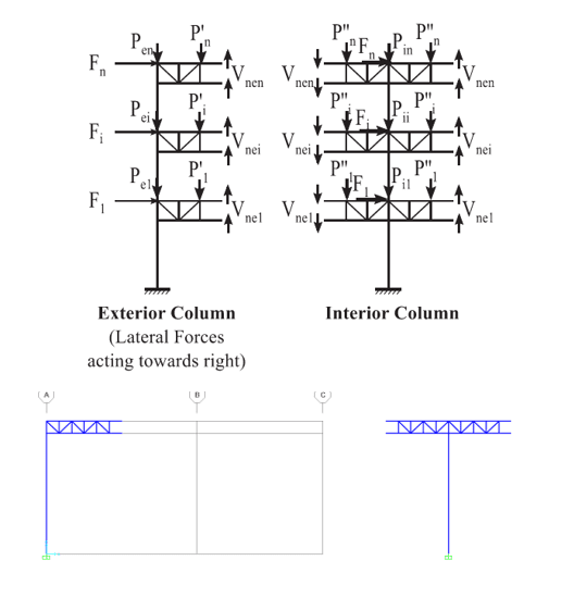

Has anyone design STMF before? I have read the AISC code and some research papers. I came to conclusion how I will design the frame.
1> First make a 2D model and find the shear demand on the special segment of STMF. Select a section for the special segment which has expected vertical strength calculated from E4-5 greater than the shear demand.
2> Design of elastic segment-> Consider the portion of the 2D model and add a vertical expected shear as a load to the structure (see figure). Add this expected shear load case to all load combinations. Determine the demands on all other members of trusses and also columns and design for this load.
3> Provide the necessary detailing based on AISC.
Please let me know if there is anything.
all those sketches use beam caps to carry the transverse shear over the last bay (without the diagonal).
