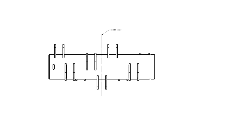

I am trying to solve the moments off the center of ears 1, I attached a PDF that shows my work and my thinking (again I am new to this) looking for guidance and to make sure I'm not chasing my tail on this one.
So far I have 8 unknowns and 2 equations.
I have attached my work below along with a picture of the rotating piece in question.
Thanks for taking your time to read, any help would be greatly appreciated
If you want pure theoretical balance, you need radial symmetry AND you need symmetry about the center plane.
You have radial symmetry, but the center plane asymmetry will add a second mode that is out of plane with the plane of rotation.
You could solve this problem by either moving the ears so that there is center-plane symmetry, or by adding counterweights opposite the mounting ears (which would require you to balance the full assembly instead of just this 'rotor').

Yes-that is what I mean.
I would suspect that if you instrumented the feet or legs of your machine, you have a 2nd order waveform through that plane.
If you use counterweights to balance each load point on the shaft, then no- the odd number of eccentric masses will not present a problem.
IF you consider the rotor to be rigid, then the above approach seems reasonable (targeting static balance and targetting mass symmetry about the axial center plane).

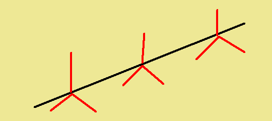

For 9 ears simplest scheme dynamically (and statically) balanced is this (120° between ears in every group)
pic.1
Each group is symmetrical and therefore balanced.

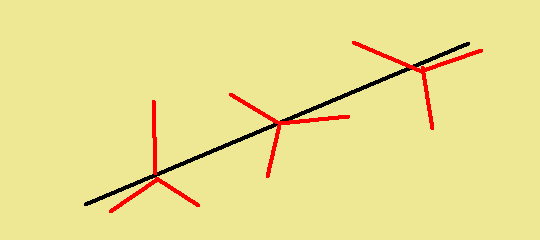

also every group can be rotated in any angle - symmetry is not broken
pic.2
and in this case - (imho) rotor is statically and dynamically balanced too. (120° between ears and equal distance between the ears)

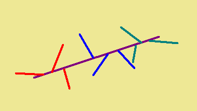

pic.3
and you can add several distributed groups - and rotor will statically and dynamically balanced too.
pic.4
Yes, this is true for rigid rotors.
