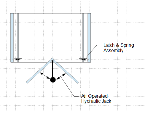

Think how a cardboard box is designed. There are two sets of flaps (doors). The innerset holds the load and the outer set basically only holds the inner set closed. You can do the same thing with a piano hinge at the side of your doors. One leaf of the hinge folds over the doors, holding them closed. A single latch holds this leaf in place. Pull the latch, the hinge leaf swings out of the way and allows the doors to open.
Would you consider this with some modifications.

I have seen hoppers that required manual reset of the doors. They had to be held in place by hand and then bars under the sides held them closed. A lever on the side simply pivoted the bars out of the way and allowed the bottom to drop open.
Very crude, manuel and no control. But functional.

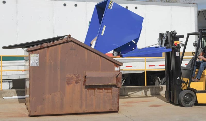

the box is carried on a fork lift. presumably the box has an open top ... to put the ash in the box. what about tipping the box ? that'd make for a better box.
you could build into the box something to hold onto the fork lift (a couple of rings ?) then a lug and a rope and you're done ... maybe a block and tackle. Use the other lower side (the other one is "fixed" to the fork list) and the box could be lifted (rotated) to vertical, then use the fork list arms to go beyond the vertical.

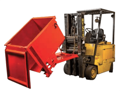

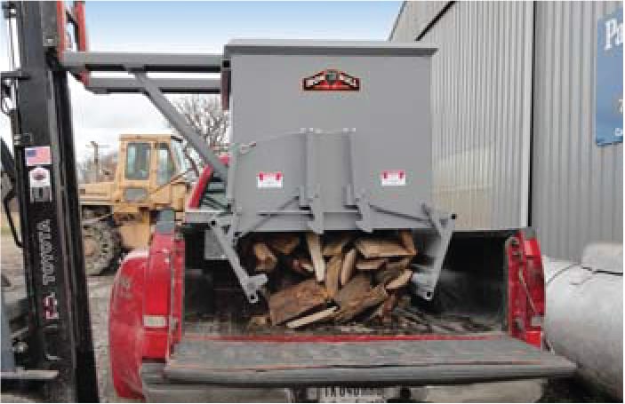

You might be able to find something that fits your needs off the shelf. We used a lot of ones like rb1957 is describing for scrap metal. The last picture shows exactly what you are describing, search term is "bottom dump hopper". That one is from these guys:[URL unfurl="true"]https://ibullmfg.com/trash-hoppers/drop-bottom-hoppers/[/url]

I was thinking along the lines of hendersdc bottom picture but instead of the side mechanism to open and close the bottom hatch in his picture, install a counterweighted lever to keep the bottom door closed and to open the bottom door move the counterweight by hand but keep safety in mind with my suggestion.

Several solutions including bars underneath crossed my mind too, but i couldnt figure out how a lever would move them out of the way.
Could you perhaps go into more detail or even better produce a simple sketch.

This is exactly what I had in mind, thanks so much I spent so much time looking for something like this on google and couldnt find it for the life of me,
sadly im not in the US (I'm in Europe) so this off the shelf solution wouldnt work, but I will research local options maybe someone is already making something like this.
But this will definitely serve as a great illustration of what I need.
