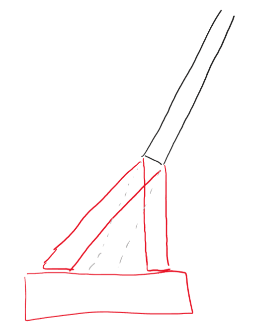

Here's a quick and ugly sketch. Rather than trying to re-establish stability through a wood moment splice (not likely to last too long in an outdoor park environment with a history of inadequate maintenance practices), create a new structure beneath it that can prove a stable mounting point. Whether you form some sort of space truss like the one in my sketch or use concrete or masonry for cantilevered walls, there are ways to do it that don't rely on wood to wood splices (yuck).

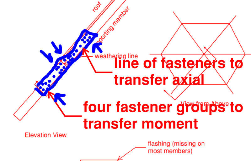

I feel that these things ought to be able to be spliced using a scheme on the order of what I've shown below if we get your design approach dialed in. With these sistered wood moment connections, usually the key is splitting your moment connection into two, spread out shear connections as shown.
This would be butt ugly but, at the same time, I suspect that it would be the cheapest of your available options, including outright replacement. Mucking with the connections at either end of the full member will usually cost $$$ for something like this.
