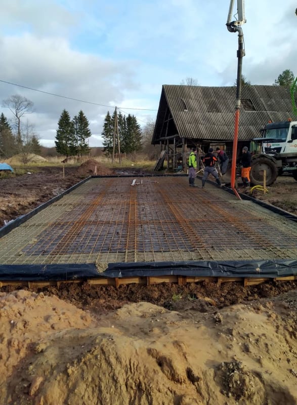

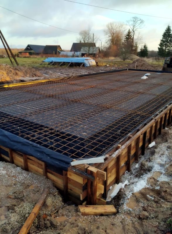

I did a "floating slab" down to 500mm 400mm wide outside perimeter with rebar at the bottom hooked up to mesh in the 100mm thick slab 1/3 up from its base. 100mm foam under the lot with moisture barrier on top then the concrete.
This is my building. Clay soil no bedrock.

Where I am all foundations get the footings insulated be the building heated or unheated. It gets down to -30 C in the winter. The Polish do the same as well
Oh and the price of wood where I am it worked out significantly cheaper to build mine out of aerated concrete blocks which meant no insulation required on the walls either. If its wood framing you would still need to insulate a bit otherwise you would get condensation on the walls and roof with a wind blowing.

It was done because 1 meter frost lines are not uncommon in Scandinavia and substantial savings are made not going down that deep with the normal depth being around 400mm ground penetration when done.
They even do the same for garden retaining walls for terraces etc.
