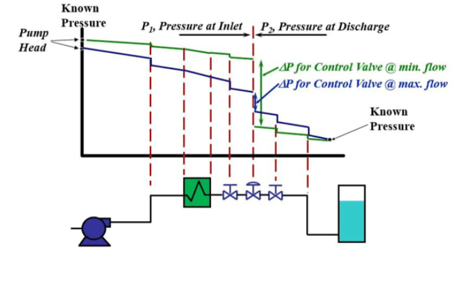

You really need to come up with a few different scenarios or process cases and provide that data to the control valve supplier.
So min flow, max DP across the CV is one. Max flow, min DP across the CV is another to bound the system.
How this affect the pump only you can know as we don't know, with this control valve in the system, whether an extra 2.5 bar makes a big difference or not.
Maybe opening the control valve a bit more will be enough to compensate? That might be your worst case noted above.

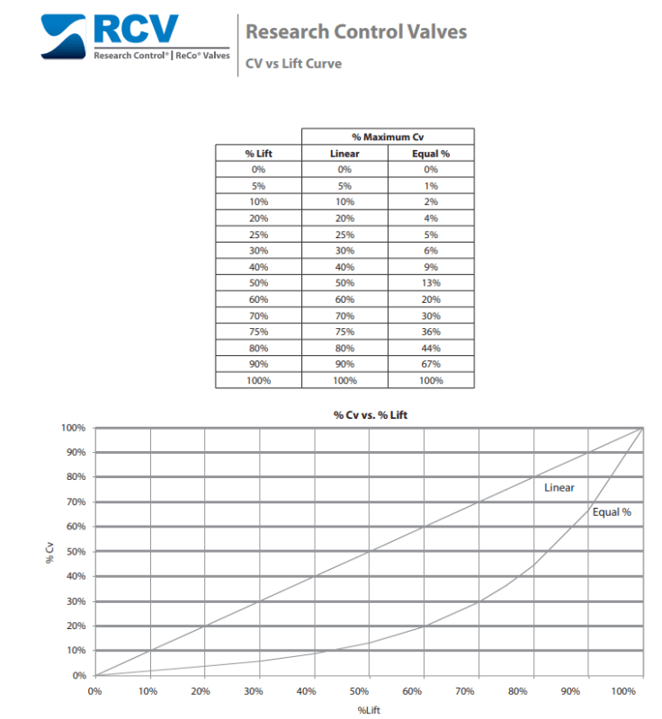

Many valve manufacturers have Cv vs. %Open curves and charts. Many do not and you will have to find charts typical for the type of valve you are considering.

I saw the datasheet of the one valves I am considering and it mentions Cv vs lift. I guess that manufacturer uses lift instead of %open.
That's it. Interesting. Not seen that before. Always something new to learn.
Maybe it refers to the % of raising of the valve stem in the actuator mechanism. ?? Who knows.
But that is apparently what you need. Since the values are normalized in % vs %, it shows characteristic values for all linear and eq% valve types as a % function of Cv at full open.

Muud said:
So shouldn't this value be supplied by the valve manufacturer as they know what's the inherent drop caused by the valve at different flow rates?
The valve supplier has three main variables to consider for a fixed fluid.
1) Flow rate
2) Pressure Drop
3) Valve CV
At the start when you ask him for a new valve he needs two out of those three. Normally the customer (you) supplies items one and two in two or more scenarios and then the supplier works out 3) within his options available for a particular valve or trim inside the valve..

No. Many mfgrs will give you Cv100. Not all. But it's usually not a problem, because Cv100 is a generally well known value for all standard valves types and of all diameters. All you need are the diameter-normalized tables. I think I can find my standard valve tables, if you can't google them up. If it's a non-standard valve, then the mfgr must supply a full table for that specific valve.

The pressure drop is the delta P in the diagram, the pressure drop the control valve needs to create over the flow range required.
