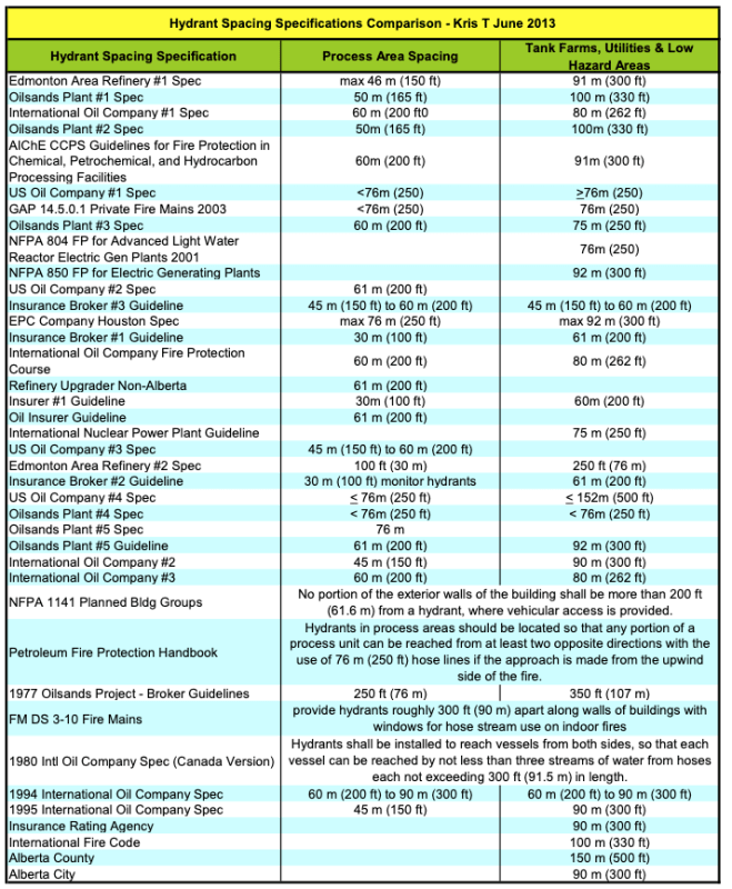

This document contains some guidance: (but, as stated by LittleInch, it may not pertain to your situation ..)
"The maximum recommended spacing of hydrants in commercial, industrial, institutional and multi-family residential areas is 90 metres; in single family residential areas 180 metres is recommended"
I agree that you need an experienced Fire Protection Engineer, familiar with all of the required regulations for your plant and can provide you with a detailed protection plan.. !!!
Section 7.2 of NFPA-24 might help too ..
MJCronin
Sr. Process Engineer
A comparison of hydrant spacing guidelines in the attached list f
or interest.
