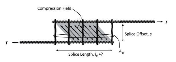

Definitely test results and intended to capture two effects primarily:
1) When the bars are literally in contact, part of the perimeter of the bars is no longer available for bond with the concrete.
2) When the bars are as far apart as code allows (6"), the tension in one bar is passed to the neighboring bar via compression struts in the concrete that require some to form. Like the sketch below but without the cross ties.
At the extremes, it's about one or the other of these effects. In between, it's a combination of the two potentially.
PS: I realize that you already know most, if not all, of this stuff already. This is mostly for the benefit of the conversation at large. Your question simply made for a convenient springboard.
DaveAtkins said:
When you have different elements which are not positioned close to one another, "development length" applies. Each element must be developed.
That statement makes me a bit uncomfortable without a corollary with respect to element offsets that cannot be considered code compliant lap splices:
By itself, development of each element does not guarantee that tension can be successfully passed between those elements. To do that, one must make recourse to either reinforced concrete design principles (STM, Widianto, AISC Design Guide 01) or concrete anchorage theory (appendix D) in addition to developing both elements.

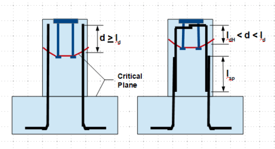

A "splice" is when one bar in the bar group is the continuation of another bar. In other words, the two pieces must be equal to "one integral bar" strength-wise. The splice length is the overlapping length.
The "development" is usually pointing to the end of the bar that is embedded in the concrete to develop the yield strength of the bar across a defined/critical plane on the other end, whether it is embedded in the concrete or not.
The development length is the length passing the defined/critical plane and measured to the developing end.
For spread footing with anchorage, you might run into situations as shown below:
I feel that is too restrictive. In my view, and in the context of OP's question, a "splice" is the passing of tension from one reinforcing element to another without resorting to the use of concrete breakout frustums to resist direct tension. Here, the elements being spliced are:
1) The pier rebar and;
2) The anchors.
The business about development across critical planes is all just poor man's strut and tie design. It doesn't in any way change the nature of the problem as being, fundamentally, about lapping the pier rebar with the anchors.
