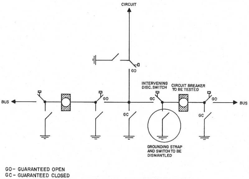

Wrinkle: in GIS installations, mechanical interlocks between breaker disconnects and the "inside" grounds would be very problematic, as our electrical maintenance crews routinely remove the ground links from one of the inside ground switches to provide an access point for breaker timing tests, with the next bus section on that side of the breaker also isolated and grounded. By this means the now-ungrounded side of the open breaker can readily be grounded whenever desired by closing that breaker disconnect utilizing grounding continuity.
[URL unfurl="true"]https://res.cloudinary.com/engineering-com/image/upload/v1606496395/tips/Typical_HVGIS_Work_Zone_cpcdab.bmp[/url]
Mechanical interlocks would prevent closure of the breaker disconnect on that side with the ground switch closed and render equipment grounding by this means impossible.

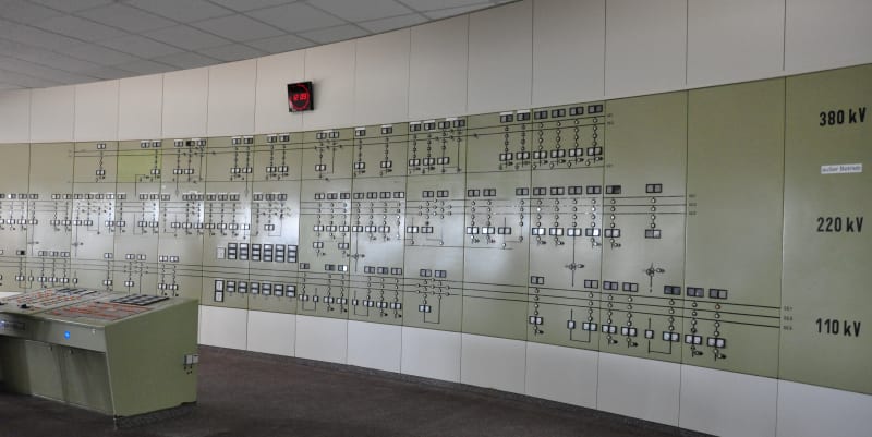

From the sounds of it I need either electric or electronic interlocks regardless. Despite the migraine in interlocking a station along the lines of this, which as you guess makes me want to "keep things simple":
