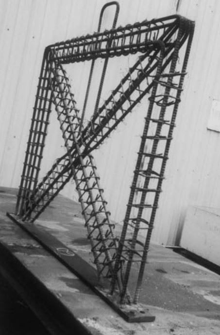

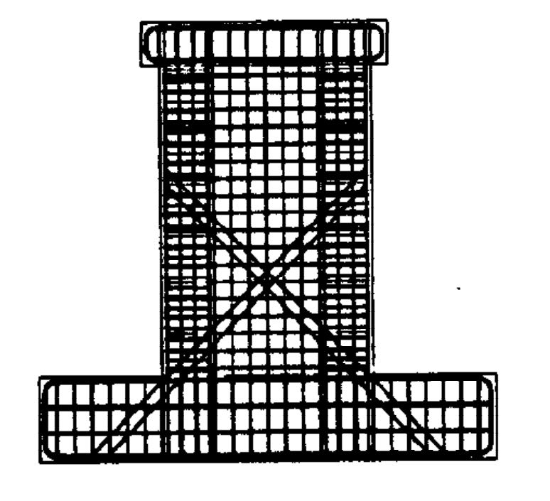

Maybe (not). If that is the case then it should also happen to the shear walls in the pictures. Tension in concrete is resisted by the bars cmpression is resisted by the concrete, its just an application of the strut and tie design method as I see it.
A few things to consider with regard to that:
- The second clip is really just bars placed to prevent sliding failure. The primary reinforcing is still, clearly, rectilinear.
- The first clip reinforces the diagonals like columns so may well still substantially represent a concrete diagonal member.
- Don't take this the wrong way but the first clip comes from the text of an author who is a bit of a crack pot. Claims to have discovered some new laws of physics that Newton missed etc. The concept didn't gain any real traction, likely for the reasons discussed above. A few cons and no pros.
