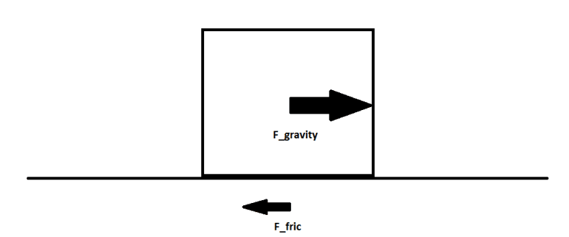

I am trying to understand the difference between the two models; The obvious one is that the penalty formulation has an elastic slip before reaching the slipping state, while the classic coulomb goes directly from sticking to slipping. I am working with a box on a plane, and I want to simulate a box on a plane which is pushed by a force, and then compare the Abaqus velocity, acceleration, and displacement vs time plot with analytical results. Will the results be similar? I tried running simulations, and got the same constant acceleration after elastic slip, but otherwise the Abaqus and analytical results do not match, and I am not sure if my model is incorrect or if the two models are incomparable.
"In reality the elastic slip is assumed to correspond to the elastic displacement in the surface roughness." - is the elastic slip the displacement required for the box to "break free" from the plane? Does this elastic slip exist in the classic coulomb friction model?

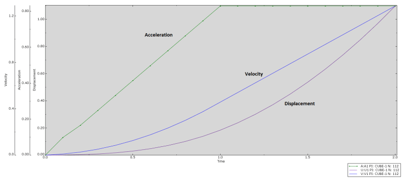

This is how my acceleration, velocity and displacement curve looks for the box on plane model with force pushing it horizontally. Since penalty method introduces finite elastic slip I assume this means I cannot get these results analytically? I will probably need experimental data to confirm the abaqus results then. Is elastic slip just some finite element model concept or is there a physical explanation for it?
In case of models where friction is crucial for results, it is necessary to use Lagrange multipliers method to obtain accurate output. You can also try reducing maximum elastic slip setting for penalty method (to increase accuracy) but this may result in convergence difficulties.

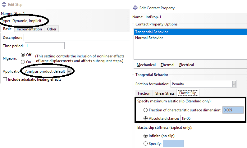

Limiting the elastic slip with the penalty method I get this acceleration curve:
Could I ask what is the wavy part of the curve is before it converges - is it the springs trying to adjust to the allowed elastic slip?
And why doesn't the box simply fall off immediately?

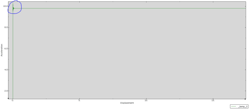

This marked part of the acceleration vs time plot looks like a typical numerical noise. Can you say more about this analysis ? What kind of step is that ? What are the boundary conditions, loads and contact settings ?

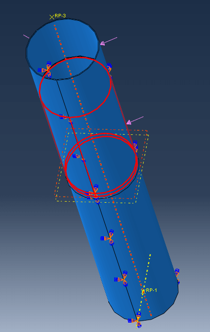

This was a box on a plane model, but ultimately the goal is a grouted joint model.
Steel part inside and outside, and grout (concrete) in the middle.
-There is a normal pressure on the entire model to activate coulomb friction.
-Gravity is turned on, acting in the vertical direction.
-Inner steel part and concrete is encastered, will change this in the final model to only fix inner steel part.
-Surface to surface contact between the concrete and steel parts.
-Finite sliding (Any idea how the sliding formulation come into play here? I could not see a difference between finite and small sliding when I ran the model)
- Dynamic, Implicit with default load application so that I may limit the elastic slip. Will use quasi-static load application in the final model.
- Acceleration vs displacement curve of the outer steel part
- "Wavy" acceleration in the beginning again before it converges. Wondering if this is due to the penalty method and reduced elastic slip. The more I reduce the elastic slip the smaller the "wavy" part becomes.

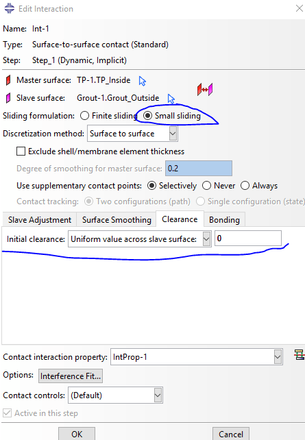

When it comes to sliding formulation, small sliding should be used only when you are absolutely sure that this assumption (of small sliding between the two surfaces) is valid. In such cases the numerical cost of the analysis will be lower. Otherwise, the results may be completely inaccurate.
I wouldn’t worry about this noise in acceleration curve. You can try eliminating it with filter applied to XY data, though.

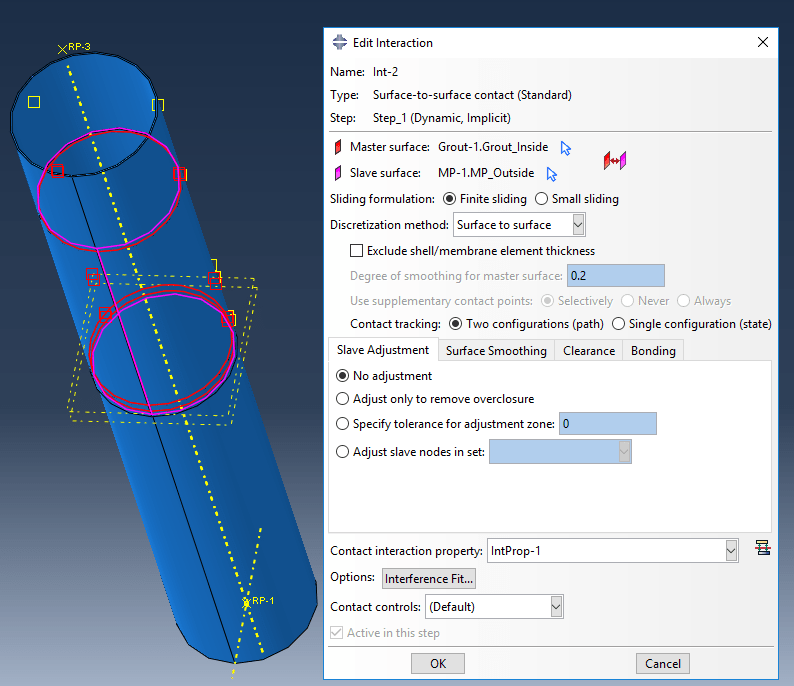

Just last question in this thread; when I go from small sliding to finite sliding I cannot use initial clearance to establish contact, which would give me a perfect initial contact condition, is there a way to get good contact conditions with finite sliding formulation? I tried doing the part sketches of the cylinder so theyre exactly touching, but this did not help much. Any ideas?
You can use surface smoothing option, it's designed for such curved geometries. Also make sure that slave adjustment is enabled.
