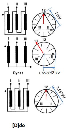

Hello everyone!
I am struggling a little bit with the input data for 3-W transformer when it comes to Digsilent my purpose is to study only symetrical short circuit. Have anyone some experience with that?
My input:

So based on this I have calculated the Sn for each winding (HV - 5,2 MVA, LV - 2,6 MVA, MV - 2,6 MVA)
My question is how to enter the positive sequence impedance (if via calculated copper losses + calculated usc% or with the uk% and re(uk))
and the second how to input this phase shift (-7,5°) - I got an an constant error to this.
Thank you very much in advance for any help! I really don´t know what to do :/

If the transformer symbol is according to IEC 60076-1 the connection is as following:
It is not possible to upload any image.I am sorry
There is a natural phase shifting[0 to-7.5o] considering the voltage drop through the transformer from I=0 to I=1.13xIn
Sorry. At D-do connection the phase shifting depends on power factor and current level. At D-yn11 connection , initially is 30o and from here the shifting depends on current module and argument.
