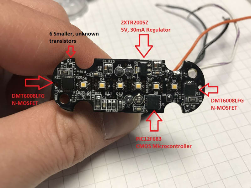

So to bring more clarity to this topic, I took a picture of the inside of the module (back of the board is unpopulated).
Main components I could identify are as follows:
Controller:
PIC12F683
[URL unfurl="true"]http://ww1.microchip.com/downloads/en/DeviceDoc/41211D_.pdf[/url]
Likely powered by 5V, 30mA regulator:
ZXTR2005Z
[URL unfurl="true"]https://www.diodes.com/assets/Datasheets/ZXTR2005Z.pdf[/url]
There are two N channel MOSFETS:
DMT6008LFG
[URL unfurl="true"]https://www.components-mart.com/datasheets/82/DMT6008LFG-7.pdf[/url]
There are 6 LEDs that I cannot identify... and what would appear to be 6 very small transistors (my guess as they have a 'Q' designation).
I don't see any evidence of any other components like inductors that I have seen in switching regulators. Only small caps, resistors and a few diodes present.
My initial guess was that the PIC controller is switching the larger MOSFETS to turn the LEDs on and off, but the coincidence of 6 LEDs and 6 smaller transistors is throwing me off. These light modules are intended for automotive use (emergency vehicle light bars etc)... so perhaps there is something going on to protect the LEDs from voltage spikes produced by the vehicle's electrical system.
Let me know what you think. Really appreciate the responses so far

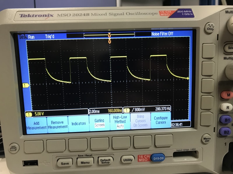

A little more info... so the brand of lights is Whelen if you guys didn't see the little label in the picture I posted. They have a programmable flashing module that apparently we just so happen to have. So I was playing around with it and it can dim the lights with only the power and gnd connected... I started prodding the connections with a Fluke 177 true RMS meter.
My power supply is putting out 12VDC ... The readings I got at the output for the LED module for each brightness level are as follows:
100% brightness --> 12VDC --> N/A VAC --> 200Hz AC --> 0Hz DC
70% brightness --> 9.6VDC --> 3.8VAC --> 200Hz AC --> 0HZ DC
50% brightness --> 7.5VDC --> 4.75VAC --> 200Hz AC --> 0HZ DC
20% brightness --> 4.12VDC --> 4.33VAC --> 200Hz AC --> 0HZ DC
0% brightness --> 2.7VDC --> 3.45VAC --> 182Hz AC --> 0HZ DC
I set the meter to both AC and DC to see how the readings would differ. I'm not sure if the AC setting would respond different to a PWM signal or not. I'm not experienced in taking these sorts of measurements but I did read that using the AC setting to check DC voltage would not damage the meter.
Now where I am confused is that if I remove the module from the programmer and just wire it directly to my power supply and adjust the DC voltage to lets say 4.12VDC as was read for the 20% brightness... the LEDs do not come on. They turn off around 7VDC direct from the power supply... So when I took the above measurements, am I reading some kind of average 'ON' time from a PWM signal perhaps?
And since I have the programmable module, before anyone suggests just using that... its quite large. Too large to fit into a portable device. I'll see if someone in my building has a scope to see if it is a PWM signal then?
Got it on the scope ... see attached. So yes, with 12V supply and the programmer set to 40% brightness, there is a 200Hz frequency, 5ms period... 40% on time
So now I have to revisit the 555 timer circuit to do this
My last little bit of curiosity is this... when I first power on the LED module (no PWM), my power supply reads a higher current draw and then after about 5 seconds of being on, the LED modules settle at about 1/2 the peak current of when it was first turned on... Now when I PWM them at a lower brightness (ex: 40%), the current draw is still slightly higher than the "settled" current when I just directly connect the 12V supply to the module. I thought PWM should reduce current consumption since there is a considerable "off time?"
Need a clearer close-up picture. NOT taken against a WHITE background so the camera doesn't stop way down making the board extra dark. Maybe just attach it to the post so it can be more than a Mbit.
Got a part number of this thing?

See attached.
