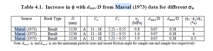

The lab run by Marsal claims to have handled 113 cm specimen rockfill.
Table from Kurt Douglas thesis on the shear strength of rock masses. The book Geotechnical Engineering of Dams references his thesis and also indicates the following regarding shear strength of rockfill based on size.
Geotechnical Engineering of Dams said:
Most accept that shear strength
increases with particle size (Chiu,
Douglas), but some claim no effect
(Charles et al.), or the opposite effect
(Anagnosti and Popovic)
