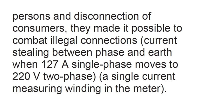

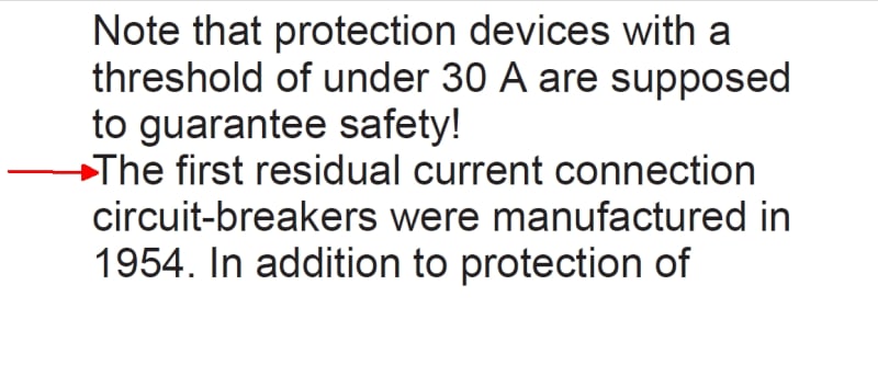

IF I may to it again- I disagree that Daziel invented the GFI or the concept.
Page 6 of this link:
GFCIs were so effective because they offered a solution to the countless 2 prong metal framed tools that were shocking and killing individuals. Even to this day I see toaster ovens and metal heaters with 2 prongs being sold.
It is good to know that the historical timeline of the ground fault protective device. I also learned that in 1955 a 500V prototype of RCD was developed and patented a year later in South Africa and Australia.
The RCD used in Europe and the GFCI in the US are using similar principles and some differences in the design. However, the benefits of reducing the number of dead by electrocution are noted over the years. For example, prior to the NEC requires Install GFCI in the US about 1,100 accidental electrocutions per year and now that has reduced to over half that number (Link) even though electrical usage and components have grown exponentially.
[sub]Annedopt & Reference: For those interested in the physiological effect of current on humans, a good reference can be found in "Applied Bioelectricity: From Electrical Stimulation to Electropathology By J. Patrick Reilly" (Link). We did learn the fundamentals and applied some of the references in a challenger grounding design interconnecting two HV substations via superconductor feeders in NYC.[/sub]
When you have neither double insulated products nor EGCs electrocutions are going to be a given. GFCIs/RCDs were a way to help speed combat that issue.
