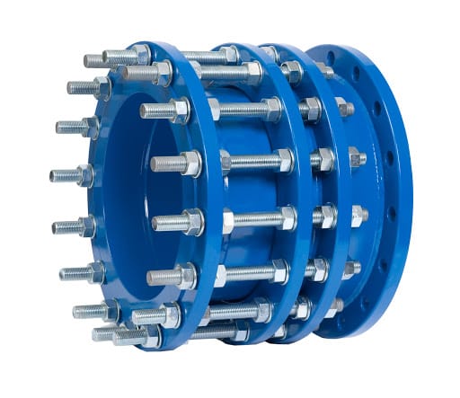

I attach an image of component which I mean.
Our expansion joint has not been finalized yet, but it is preferably rubber single type, and it connected to pump nozzle.
DISMANTLING JOINT:

Dismantling joints are used where it will be difficult to remove the piping because of clearance limitations. If you are routing the pipe straight from the wall to the pump, you will have problems removing the suction pipe at a later time.

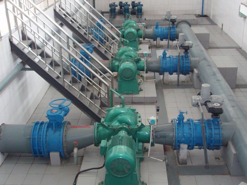

- The use of fixable dismantling joint will be necessary if the pump can not installed again if dismantled for any reason. That is, if the pump inlet and outlet piping has axial thrust to pump , and the outlet piping is connected to header , you cannot install the pump if you do not dismantle the total outlet piping. You should question that, Can each pump be dismantled and installed separately ? if yes you do not need dismantling joint..
- The use of expansion joint: Is this recommended by the pump manufacturer ? . If not, i want to remind that, in case of expansion joints at suction and pressure side, the pump casing, frame..will experience the full thrust.. That is, you are expected to ask manufacturer's permission!!!
I suppose that the pumps are omega type centrifugal pumps similar to the picture below;
