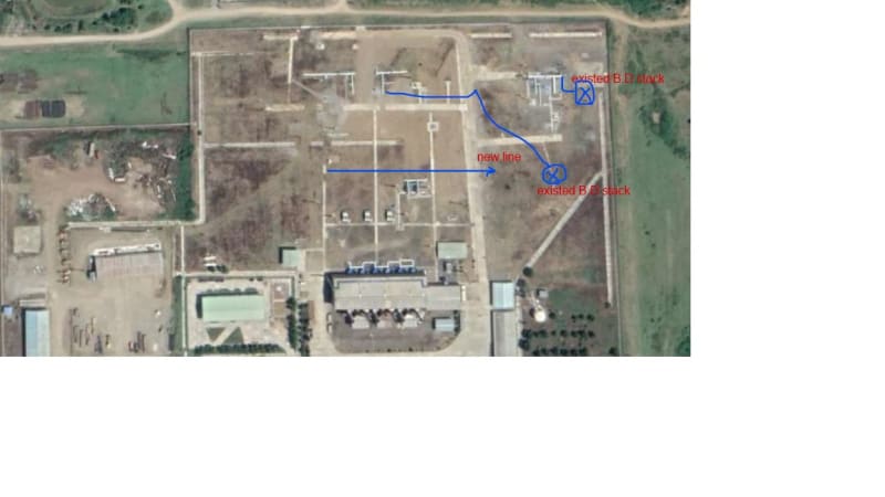

In a natural gas pressure boosting station, it is necessary to add a blowdown stack for emergency evacuation of the compressor station gases.

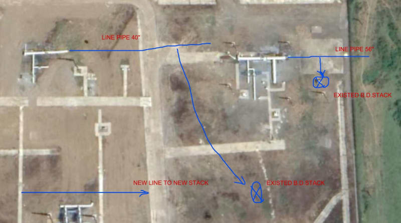

While in the area there are two stacks of incoming pipelines (56 and 40 inches), so in order to locate the third stack, we need to know the safe distance between the stacks.
Of course, I referred to the API 521 standard of the 2014 version, but the distances seemed very strange, and because I did not know the safety standards, I need help.
Thank you for your guidance.

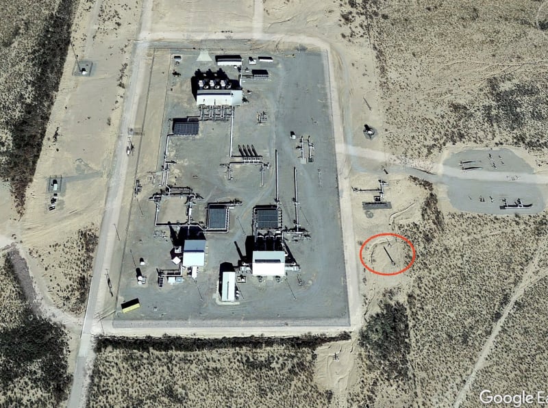

see attached image for location of blowdown stacks - there are 3 16" diameter blowdown stacks for these plants in this compressor station. 30 & 36" pipelines.
Locating them away from property lines may be advantageous.

As I said, with a 16-inch line we want to vent the gas in the area of the gas station (between the inlet and outlet valves to the shed where the compressors are located)While in the common area with the inlet and outlet pipeline of the station complex, two other stacks are already available and I want to know how far I should be from these two stacks to locate the third stack. It should be noted that all three stacks are 16 inches
The pipeline code is Asme B 31.8, but as I said, for safety distances as well as considering the prevailing wind, I referred to the api 521 standard, which I thought was very strict.

I want to specify the location of the new stack according to the existence of two existing stacks
I mean, I want to know what the safe distance should be from these two dear stacks[smile]
And also about the height of the new stack, how high it can be.
It should be noted that the existing stacks are about 3 meters above the ground

But our problem is how far the new blowdown stack is from the two existing blowdown stacks. And that the new blowdown stack is only designed to connect to the compressor station ESD system.
So forget the process design of valves and pipeline problems because this has been done and the current issue is the location of the new stack.

The problem is that we are in an urban area and it is not possible to buy extra land. Also, the problem of the prevailing wind is another reason.
The only safe area I can use is the area inside the attached photo, which unfortunately already has two more stacks in place.
Anyway, thank you for your attention, friends, I think I should involve my safety and electrical engineering colleagues in my organization in this issue. Or refer this post(thread)to a safety engineering association in this forum.
