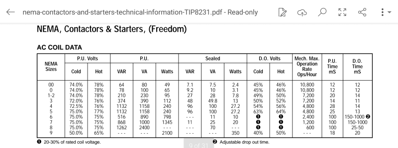

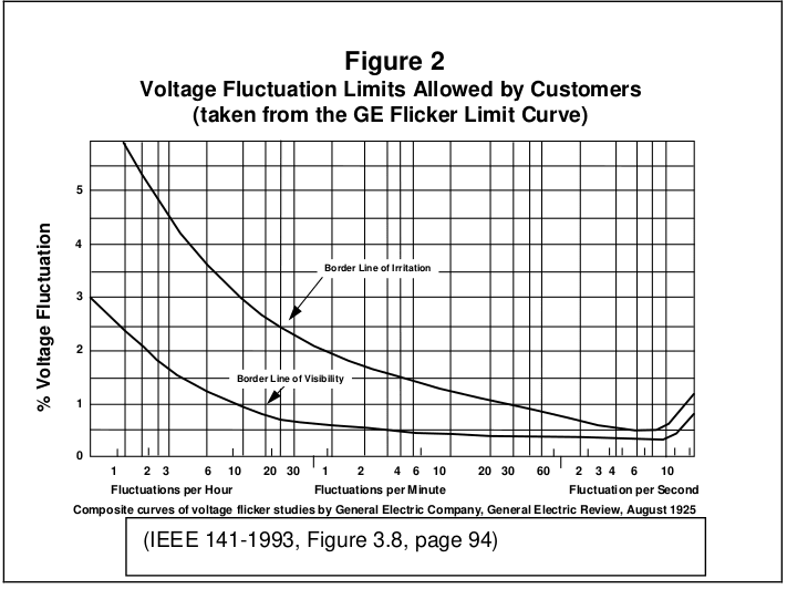

Is there an IEEE or similar standard for recommended max voltage drop on a 480 V distribution system during a motor start? I'm evaluating options for reduced voltage/soft start/VFD start for an existing installation - we can figure out what the transient voltage is, but I'm not sure of what voltage transient is considered too low. I've assumed a 15% drop is acceptable, but don't have a good basis for that.
