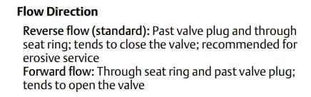

Do ball sector valves with double eccentricity (eccentric rotary plug control valve) allows process pressure to assist with opening the valve?
Seems to me the shaft offset puts a moment on the ball from the shut in pressure. None of the valve vendors sites I looked at mention this.
