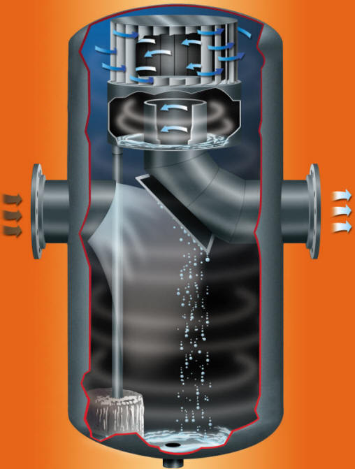

The physics of fast response to a step change in steam demand is the same for a boiler and a steam accumulator. As the pressure drops the bubble fraction in the water increases, you can work out the details from the steam tables. Once the bubbles form they need to rise to the surface. In the extreme case the boiler or accumulator will foam, resulting in carryover.
In either case the steam is saturated, and if dry saturated steam is needed then either a significant volume is needed for the fog to settle out or some sort of mechanical separation is needed.
You could put a mechanical separator inside the accumulator similar to what is seen in a fire tube boiler,
or you can use a separator in the discharge line
These devices claim the ability to remove fog from steam to 10 microns.
Internal elements are available
