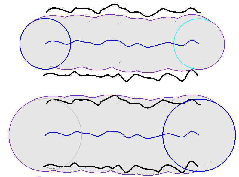

Hi all,
I am trying to understand "spines" as defined in ASME Y14.5.1M-1994 (R2012).
My question is simple: How do you construct your 2 spines (1 for MMC, and 1 for LMC)?
Without the spines, you can't measure your actual local sizes and find the actual MMC and LMC size, in addition to the actual mating size.
I would appreciate it if anyone could shed some light. Thank you.

The relevant spine is merely a simple curve without self-intersections. It doesn't need to be established in any specific way (unlike for example a median line). As long as you can find spines that will allow conformance, these spines are valid.
Burunduk,
My understanding is that to be able to sweep spheres you have to have a spine, whether it is a 3D curve or a 3D surface. And once you have your spines (the 14.5.1M standard mentions 2 separate spines), you can cut/slice the FoS, and measure the actual local values on each section.

The actual values are one external to the material and one internal - these would be defined by the solids G(Sd,Br) where Sd is the d dimensional spine (d=0 is a point for a sphere, d=1 is a curve for a cylinder, d=2 is a surface for a width/parallel planes) and for the external actual value of an external feature is the Br = smallest sphere to which the feature conforms (largest for an internal feature) and the internal actual value for an external feature is the Br = largest sphere to which the feature conforms. The size of the sphere is not variable along the length of the spine. For a feature which is subject to rule #1 the spine for the external actual value of size is of perfect form (ie: for d=1 the spine is a straight line, for d=2 the spine is a flat surface) and would be equal to your UAME size, and the spine for your internal actual value of size is not required to have perfect form (this is for a feature controlled at MMC/RFS, for LMC I believe this would be reversed).
As far as conformance, to put it simply there must exist two spines Sm and Sl for which the feature lies entirely within the volume between two solids G(Sm,Br) where Br = rMMC and G(Sl,Br) where Br = rLMC. Again, if the feature is subject to rule #1 (specified MMC/RFS) then Sm is required to be of perfect form (if specified LMC then Sl is required to be of perfect form). Theres some caveats to that, but thats the gist.

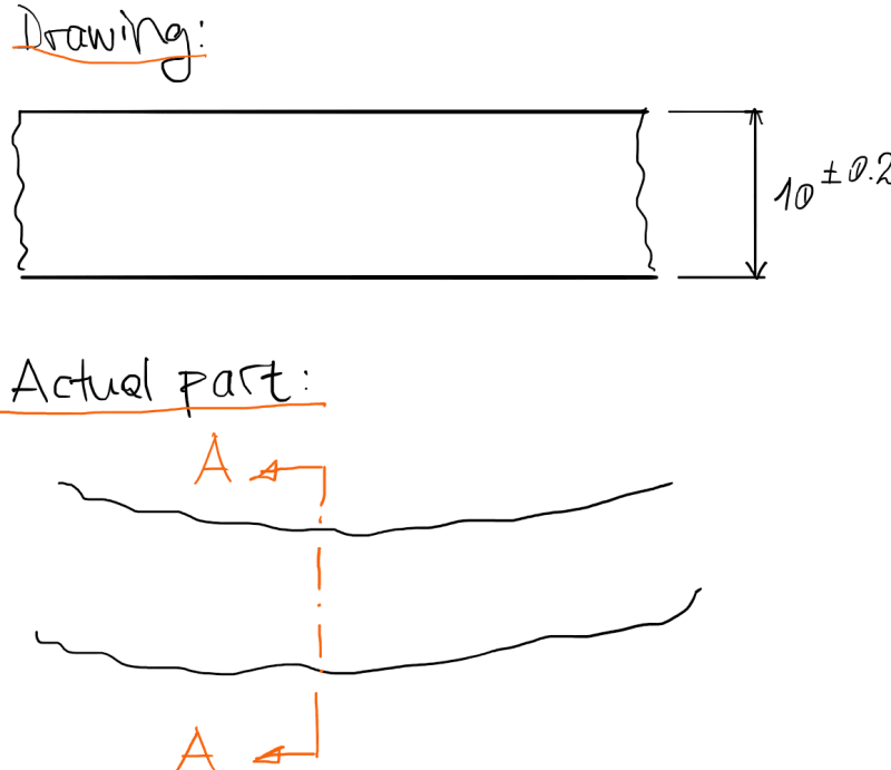

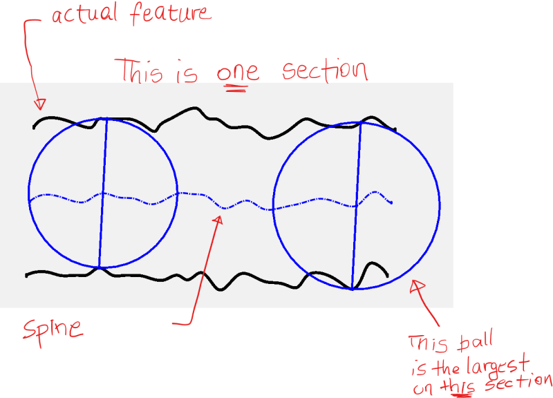

Let's say you have an external FoS (made by 2 parallel planes), and let's say Rule #1 does not apply (maybe Independency modifier was applied)... According to the standard, you would have 2 spines, each of which would be a 3D surface (looks like a ribbon). And we would have 2 fixed-size balls (each swept on its own spine), one for internal (Bl, which is the smallest) and one for external (Bm, which is the largest) to the material. How do you find those 2 values (diameters of Bl and Bm balls)? You have to check each cross-section, don't you? (Each cross-section meaning multiple cross-sections, as no one can check an infinite number of sections). What I am trying to say is, you collect 2 sets of local values. From this collection, the smallest of the smallest becomes your actual Bl value; the largest of the largest becomes your actual Bm value. (Because the part has multiple cross-sections, and each section has multiple local values). I hope it makes sense.
I have added one possible section:
Tarator,
I think that chez311's description of the two sizes is pretty good. Here is what the internal swept-ball sizes would look like for the feature and spine you drew:
As you mentioned, the internal and external sizes don't have to use the same spine. We can keep trying different spines to get a larger internal size and a smaller external size.

Thank you for the input. I think I do understand the two solids/volumes that are swept, and the 2 values: Bl and Bm.
My original question was "how to construct those 2 spines?". It is not explained in any of the standards at all unless I missed it.

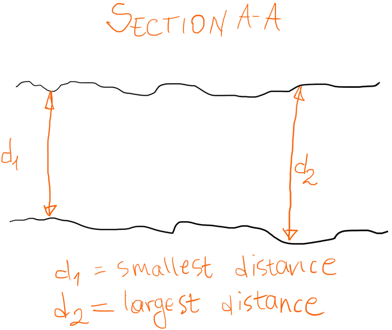

Also, the "actual local" size is not well defined either, in my opinion:
For instance, based on the images below: Which one is the actual local size on that section, d1 or d2 (it is an external feature of size)? Let's say d1 = 9.91, d2 = 10.02.
Algorithm wise I'd go with minimum and maximum convex hull creation for widths and then operate within those restrictions to shrink/expand to allow constant diameter spheres to pass through them without getting trapped. For enveloped constrained features the one spine is trivial and can be constructed without depending on the produced features. Of course for the minimum volume of the external feature there's no unique spine surface; the requirement is there is at least one.
The unstated supposition is that variation in the form of the feature is small enough that sin(theta) = theta, so all those jagged examples aren't really applicable. I recall the math standard was also implying the considered surfaces are curvature continuous. More than that, that changes in curvature are limited to the radius of the sphere.
Tarator, regarding your last post - that's why it's called "local". Both are.
You are correct, it is very poorly defined in Y14.5 and is not included anywhere in the current Y14.5.1-1994 version. The new Y14.5.1-20xx draft even specifically acknowledges this and provides two possible definitions while also specifically stating that neither supersedes or guarantees conformance to the swept spheres interpretation.

Although there is an issue with how actual local size is defined in Y14.5, what it attempts to describe is two-point measurements. Calipers and micrometers do not rely on any spines for the measurements they are used for.
The only thing missing from the actual local size definition is the specification that the distances shall be taken between opposed points, and the measurement direction shall be normal to the surface at both points.
