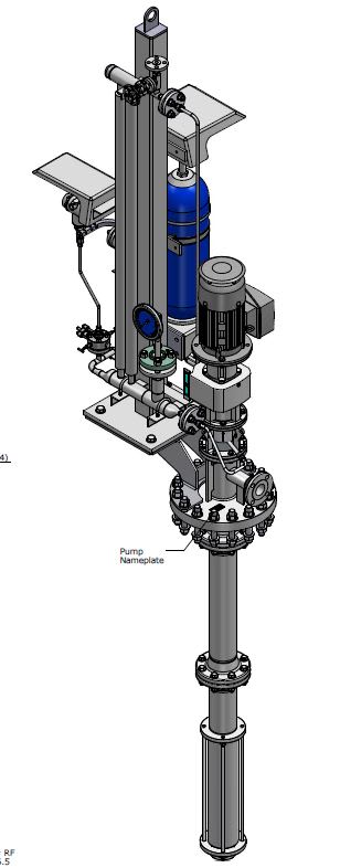

1 - "I do not understand how these things work as you described. Is there any purpose doing the assembly like that? I would normally expect that the pump suction is connected onto the nozzle by flange or weld. The nozzle was supposed to have an insert into the vessel for the suction assembly with elbow in accordance with Hydraulic Institute standards on the vertical pressure vessels."
Staticmh reply: First you understand the assembly requirement and constraints, for the horizontal vessel (especially in sump drain drums) whether with boot in concrete pit or buried condition pump assembly is require for the successful suction of the sludge contamination through submersible assembly inside the vessel (boot).
See below image of pump assembly (Isometric view) [FIGURE-1]:
Similarly now see the maximum dimension of the submersible part of pump assembly, which is marked by vendor as 245mm and understand that is the limit for us to maintain the inside diameter of the nozzle. the nozzle inside diameter should be within the range of 245mm to easily insert the pump submersible assembly through nozzle pipe.

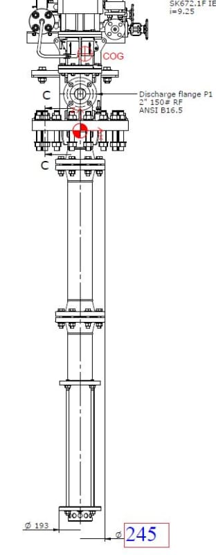

See below (blue color limit dimension) [FIGURE-2]:
But unfortunately our procurement people bought it wrongly as Schedule-80, even it was clearly mentioned on drawing to procure the schedule-60, Anyway the mistake done and being an engineer we have to solve it.
The reason why we recommended the schedule-60 was the clear gap maintain for the ease of insert the pump assy. through pipe inside.
Received pipe = NPS-10" ; schedule - 80 and ID is 242.82mm
Required Pipe = NPS-10" ; schedule - 60 and ID is 247.6mm
(Pump assy. maximum limit. is 245mm)
with NPS-10" pipe schedule - 60 , 247.6mm - 245mm = 2.6mm gap is available which is sufficient for insert through nozzle pipe.
But we have now NPS-10 , schedule-80, so it will be like that 242.82 - 245 = -2.18 mean pump cant be insert through the nozzle pipe inside diameter due to lesser diameter of pipe. now due to not having other option we intent to machine the pipe from inside to maintain the equivalent I.D of schedule-60. (i.e. 247.6mm)
