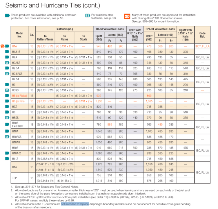

I share your frustration in this area. R602.10.8.2 goes as far as saying that heel heights of less than 9.25" in SDC A,B,C specifically do not require blocking.
I've also seen a lot of these rationalized using the hold down hardware to resist overturning but I am not a fan. If a shear wall is lightly loaded with say 200plf, thats 400# at the top of the truss (24" spacing) with a 1.5" width, so the uplift on the hold down with a 9" heel is 2400#. And you would need it in both directions. These sections make the conversation that much less fun.
I agree, this is not the way to go. Even Simpson Strong-Tie doesn't stand behind that.
DW, keep in mind the prescriptive code isn't something we are obligated to abide by if its not required under the prescriptive code and if you believe the blocking needs to be there for a structural reason, show it in your drawing as EOR.
Cross grain bending does appear to be necessary for load transfer if the blocking is omitted....
