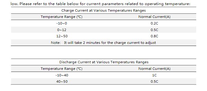

Again this isn't generally used in the USA they talk about amps
